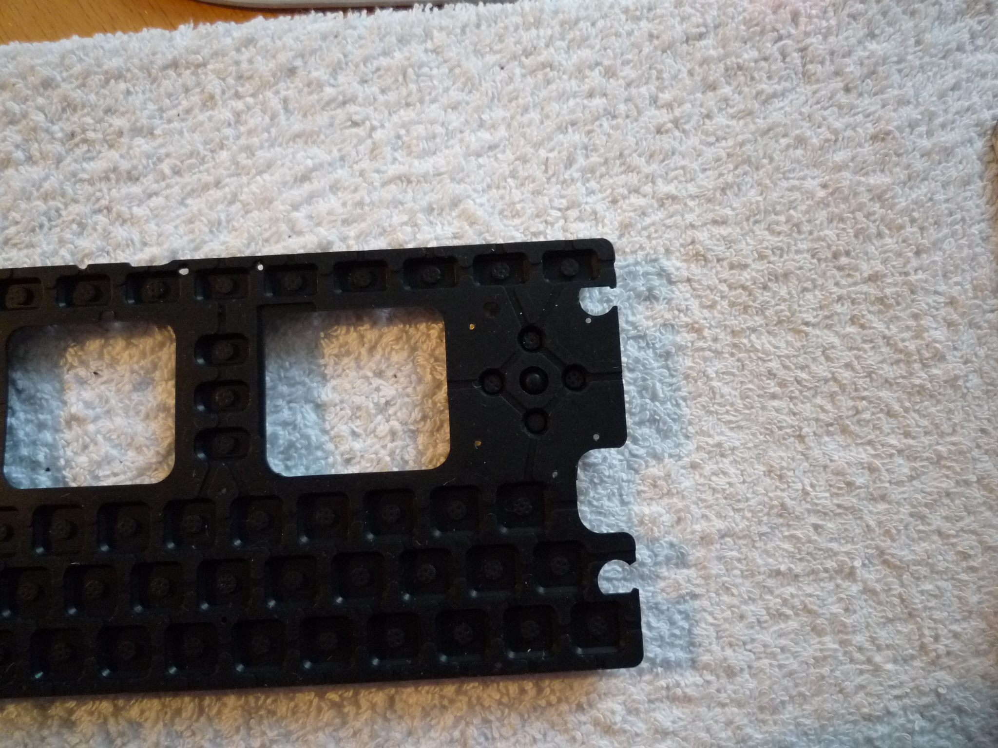

So, I popped my Pandora open, and I had a good look at the innards, trying to figure out what might be going on...
I noticed that the rubber "contact" (which I suspect is not rubber, but you know what I mean) of the down button is not meshed like all the other buttons... could this be the culprit, and is there a way to correct this ?

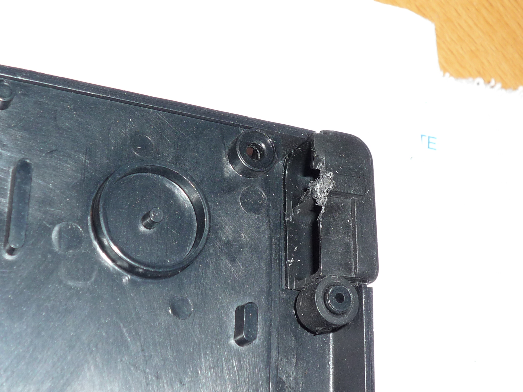

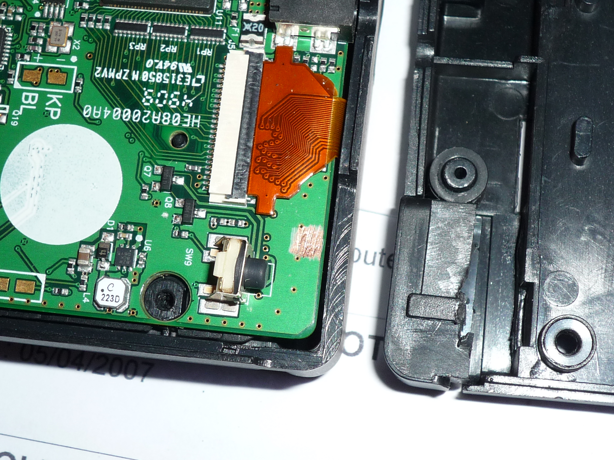

I also noticed the right shoulder button (which is actually not that "frank") received some special treatment.
It's not a big deal, since the button works, but I guess it could work/feel better.
