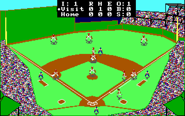

It's not a program, but actually some test pictures. As I wrote above only the pure colors do not flicker : white, blue, red, yellow, turqoise, green... see my last post on page 1
Makes me somehow skeptic, if its really firmware thing...
hmm could you still try something, I wonder if this picture will create scanlines or not:
-it looks awfull I know, just for a test :D
I'll test it this evening and I will also test an inverted version of it.
I think he means this image:

I tested the baseball picture.
Following colors show the scanlines effect:
Dark Green
Dark Blue
Brown
All other colors do not show the scanlines effect.
So the scanlines effect has to do with purity and intensity(close affinity to one of the R G B Components) of the color.
