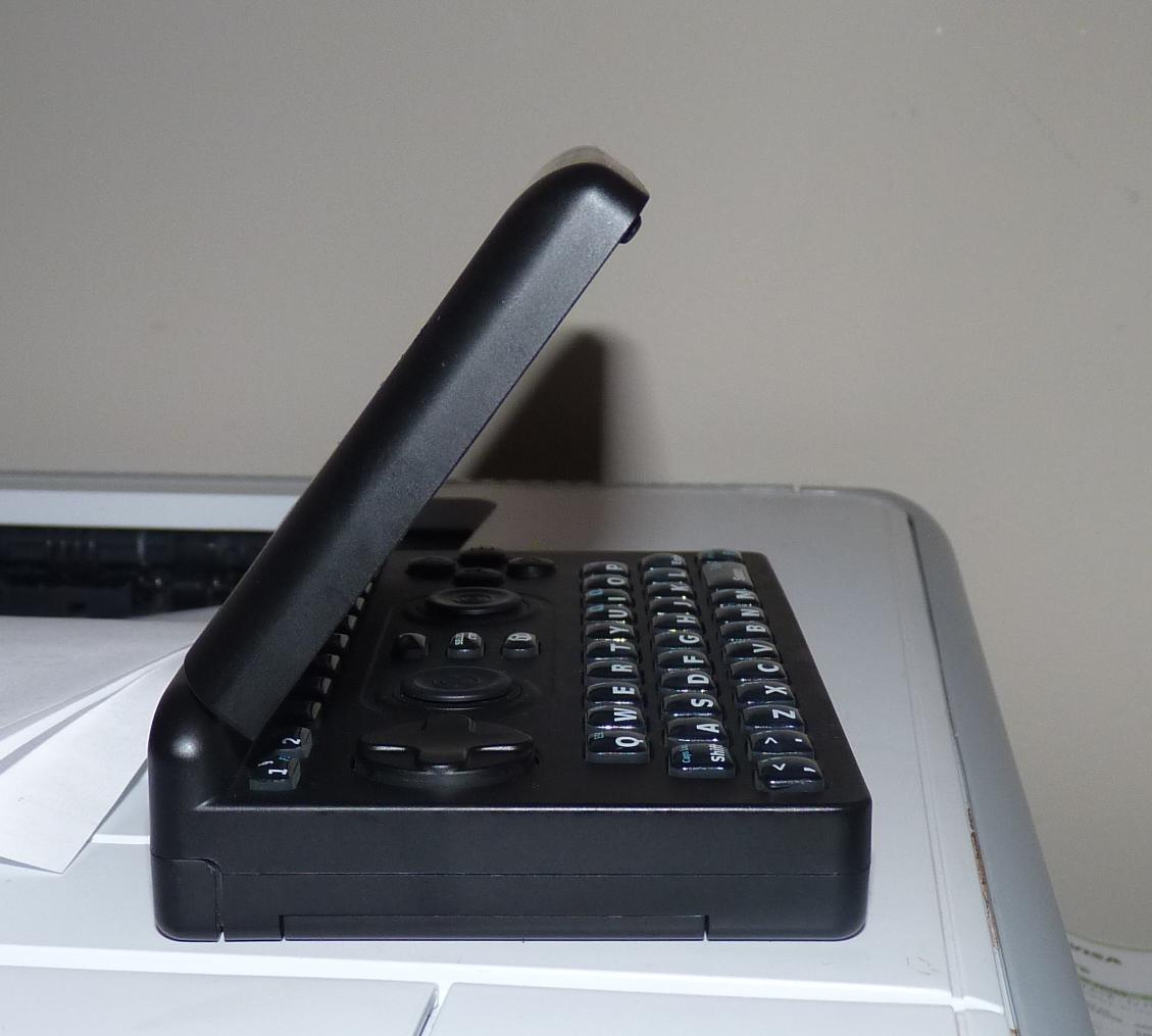

From a practical standpoint, where the hinge behavior bothers me the most is when I am laying down in bed and I need to read the keys on the keyboard. I can not do this in a fully extended position, I need to fold the screen down a little bit for the light to illuminate the keys. When I unlock the hinge the screen collapses under gravity.
God Ginrai, as for the D-Pad, I am not too concerned as I believe fixing the 0 key will make a replacement keypad necessary, thus fixing the d-pad responsiveness issues as well as the tactile feel.
So far it is good to know that Prometheus can not reproduce the hinge movement on her unit. Any other current owners out there that can speak to the hinge's rigidity/floppiness?
Do you mean that you can't do this ?
Mine have stayd that way without moving (given that i'm not shacking it)
I just tested mine vs. your example. My unit will stay open in the same position yours will. If I fold it closed any further, it will collapse, as I would expect it to.
Question: If you take your unit as shown and rotate 90 degrees counter-clockwise so the keyboard is perpendicular to the table, does your screen flop backwards? This is more the issue I am running into.
Your hinge is working as it should. It was designed to operate (lock) in the fully open position only. Some people have tighter hinges as a result of the paint that got onto areas of the parts that really shouldn't have been painted but it is a bit of a lucky bonus. I suspect that few micrometers of paint will wear off over time though. Holding the Pandora sideways and expecting it to stay at 90 degrees isn't right. I tested my unpainted prototype case and it falls faster than yours does.
As for the zero key, that is a real issue. It was hard to see your dpad but if it is sticking up in places, it may not have been glued on properly and a new keymat would solve everything. The shoulder buttons might need some excess paint to be shaved off too which is a quick fix while the unit is apart as well.
