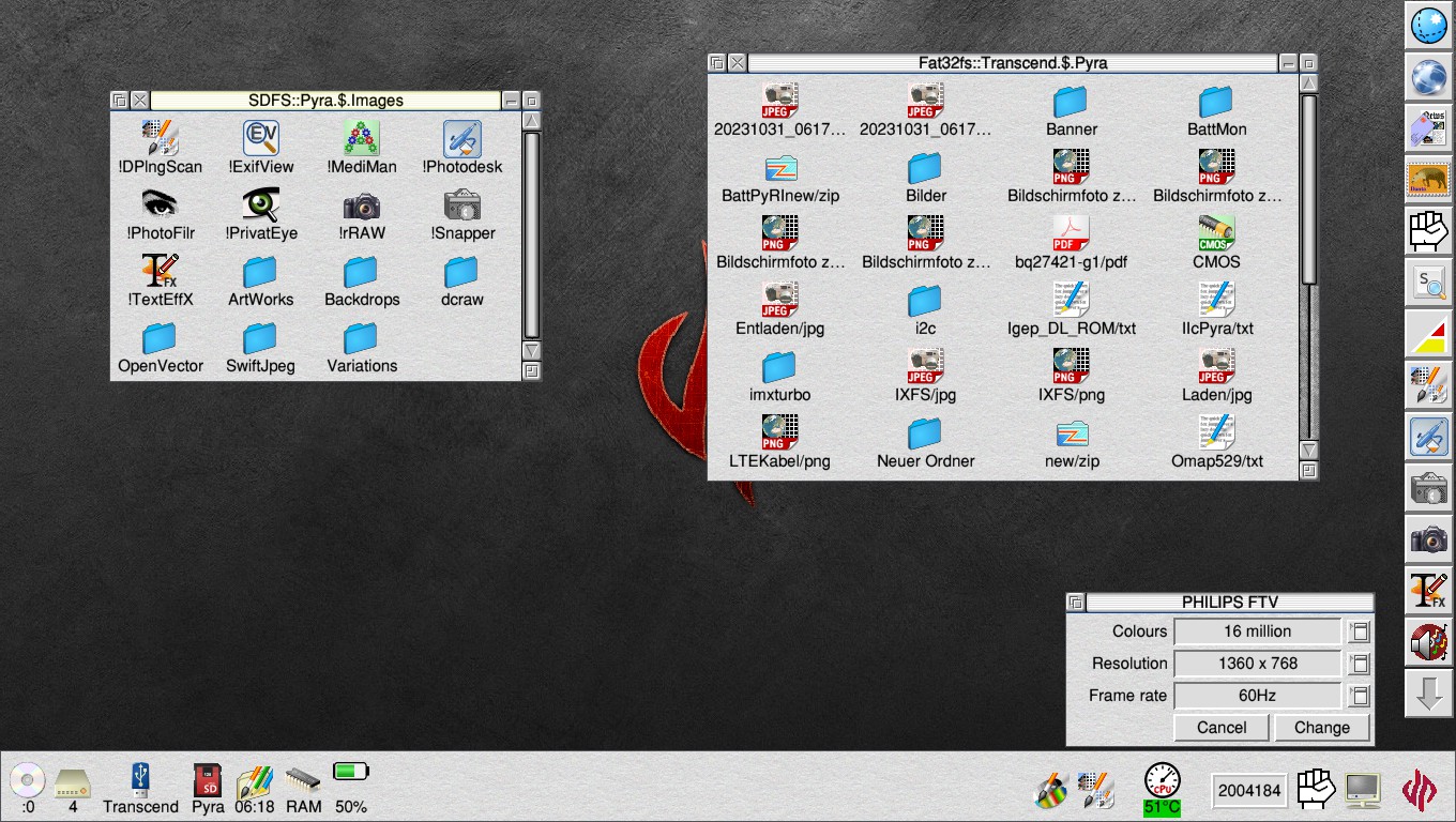

HDMI Monitor and external Keyboard is working now.
A changed Image you will find next few days on riscos.openpandora.org.

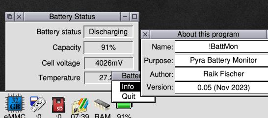

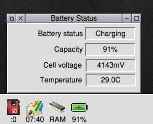

Btw, is the battery icon real? allready working to show the batttery state?
Good question. Try the Image and you will find something like this. ;-)
I boot from eMMC. You see my iconset. Is a bit different to the Alpha but the BattMon is the same.
Is a "Desktop-Pyra" only. LCD and Keyboard support not working at this time.

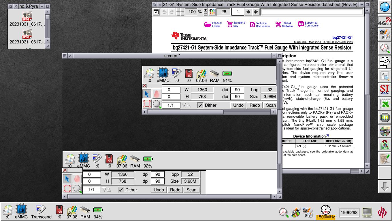

The sparkfun BattSitter use the same chipset and I use the BattSitter in my PiTab project. The changes in my code to use it on the Pyra are minimal. The charger loads up to 100%... was never working for me on Debian.
