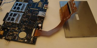

If you want it to be all internal, it would have to be fed through the hinge tubule. The FDM picture of the bottom case part plus keymat shows an opening for the ribbon outside the hinge. The question is now, will the ribbon be visible from outside while open/close or from the inside. In a tablet MOD thread was speculation, that the visible part of the ribbin could be protected by an additional sheet of plastic.
I've also seen the opening slit in the Prototype Case but I hope, the ribbon goes completely through the Hinge, which should be possible. It's going from the PCB into the left Hinge Base (where the SD LEDs are) then the ribbon is rolled sideways through the hinge of the LID and ends at the LCD onto the Lid. I came to this conclusion because the ribbon cable middle part is sloped and it would make sense to roll the entire cable through the Hinge. This way, the cable would be completely invisible AND more durable because the rolled cable prevents the cable from too much bending.
The only question is if there is enough Room into the Hinge for a rolled ribbon cable AND a stable structure (metal bolt/tube) to make the hinge durable. MWeston could clear this for us I'm pretty sure. ^_^

That said, I pulled my (clamshell/tablet) zaurus apart to fix it one day, and the wiring to the LCD was surprisingly simple in it's configuration. fusion_power is essentially correct in that it is loosely coiled before a right-angle turn that passes through the hinge; a second hinge just repeats the maneuver. When the hinge turns, the cable section through the hinge stays fixed, whilst the coil tightens/loosens slightly. It never gets close to a tight bend at any point.

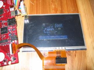

Damn, I thought about this a while ago and discarded the idea. But the pics only showed the older ribbon :facepalm:
Looking at this pic, I guess 95,73% chance, that it will be rolled up and fed through the hinge :D
edit
Older version ribbon:
Yupp, I also imagine something like this:

I've seen it a while ago but I hope, the final Units will have a more elegant way to lead the cable through the case. No modern device uses such a cheap and instable way to connect the LCD lid with the case. A simple, straight connected an not rolled up Cable will faster break than we can spell "Pandora" :(
I think, this way is needed to keep the hinge stability. Having two halfs on the bottom part like on the lid would reduce the stiffness of the hinge and would lead to a much more complex design of the case. You won't be able to see the slit in the case any more, when the lid is attached ;) To clarify, the slit is needed to put the stiff contact bar of the ribbon through the case, because this part can't be rolled. It wouldn't be possible to put the ribbon through the hinge hole of the bottom part of the case at all without the slit. The ribbon will be rolled up in the fully assebled Pandora, I suppose.
