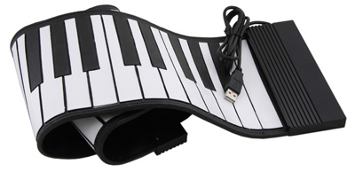

So can you basically record what you play on the Pandora's keyboard, and layer several recorded tracks on top of each other? I've been looking for something that would allow me to do that on the go. Tried those roll-up pianos, but they can only record one track (no layering). It would sure be neat if it were possible to do it on the Pandora... maybe even with a rubber USB keyboard.

Playing and recording in Milky, yes. But its a bit difficult. There is a slight delay of approx 20ms so notes sometimes are recognized at wrong rows in the table. And while recording, you can not play chords, only single notes. I enter my notes manually, channel by channel. For a chord, you need several channels. That's how mod-music works.
Just playing along a jamtrack in milky without recording works very good.
Depends on the music creation software if it is able to record "everything" you play on the input hardware. There is other more or less complex software out there for this recording purpose but not yet for pandora.
