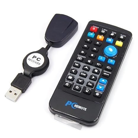

Anyone have recommendations for any additional items I should get along with it, which case, power supply etc.
Particularly interested in a remote to use it as a media player.

For a remote if your TV supports CEC you can just use your TV remote.
Otherwise you can install Yatse on your Android phone and use that as a remote control.
If you attach a bluetooth dongle you can set up a Wiimote as a remote control (But I haven't achieved this as yet)

TV does support CEC but has everything through an AV amp so would have to check if that creates any issues
Yatse on phone sounds good but would be a problem for when I'm not around.
I do have a BT dongle and the Wii has been relegated to a carrier bag in the spare room since it's last use at Christmas so that sounds good too.
I have an old Gyration media center remote I use with my Raspberry Pi... Most likely hard to get now, but really nice to use with Kodi with my Raspbmc setup.
Damn that looks like it could replace all the remotes we have.  I'll have a scour of the net for one.
I was thinking of getting something with a built in keyboard for basic input like this: http://www.amazon.co.uk/Mele-Wireless-Keyboard-Intelligent-Computer/dp/B00DI4GMVG
