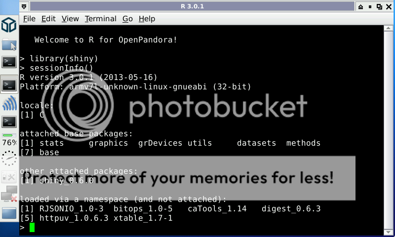

Recreating the conditions under which I get shiny to load has been, err, tricky. I tested this to death yesterday evening with no issues every time. I come back this morning and find your message  :(
So you don't think I'm going bananas:
:eek:
However, to get shiny lo load, I had to do something very odd.
All of my projects, live in a sub directory called projects on a development SD. As each one is completed, its sub directory project is moved into another sub directory called completed, which is within projects. If I need to work on a project, I move the appropriate project directory back to the projects directory. This approach is simply for organisation. All testing yesterday evening was done with the R project in projects (not completed), but only running from the pnd.
Once the updated pnd was uploaded, I moved the R project into the completed sub directory - as normal. HOWEVER, as a result of moving the project into the completed sub directory, I now find shiny will not load. Move the R project back, and bingo  :blink:
Bear in mind here that I'm not actually running anything from the projects folder - well, not intentionally anyway. So where to now? Well, It looks like that when shiny was installed, a path was written - somewhere, that references the actual location of R whilst I was working on it. This was something I thought could happen, so when I work on R, I work through a sym link in /mnt/utmp/R - which points to the pnd sub directory. To all intents and purposes, I expected this sym link approach to negate problems like this. Clearly something has confounded this approach. I'll do some digging inside the shiny package and see if I can find the reference to the path........
No luck on tracking down the path.
However, a cunning plan has been hatched. I going to uninstall shiny from the base image, re-package the result and try to install shiny to a user defined library directly from the pnd. SInce all of shiny's dependencies should remain in place, it should just be the shiny package that gets installed (which doesn't require compilation) - and I'll make sure R cannot 'see' anything in the projects directory. Hopefully, this approach will force R to use the contents of the PND as they are really presented - and not go off somewhere else to find its shared libraries.
I'll be dammed if I'm going to let this defeat me without a fight. :angry:
BIngo!  :D
Question is, will peelie "break it" again??? 3.0.1.5 will go up later this evening. Certainly, shiny now loads completely independently of my R project, codeblocks  - and the kitchen sink. And that's about as much as I can do.
An obscure posting from 2007 in the R-help mailing list provided the solution - and it did turn out to be the "red herring" LD_LIBRARY_PATH! Im not sure how useful shiny will be, or what peelie's intentions are for it.......
whay nice one shiny loads fine :)
