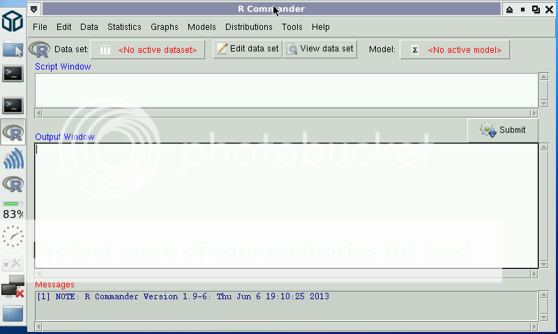

After quite a bit of work, I have re-built R with the Rcmdr GUI, and will be re-releasing it within the next week (I shelved work on RStudio for the time being - I ran into a lot of brick walls and am still smarting from the experience). :unsure:  Rcmdr uses tcl/tk, so the interface isn't exactly sparkling (hey, this is statistics :P  ):
but it may help those who run from the command line!
