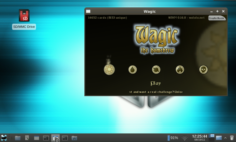

As you can see, I have managed to get the main menu running on the pandora. But; it does come with its problems. I have compiled this with Qt with the modified make file attached. Wagic has been compiled with opengles 2. In addition I had to edit Jtypes.h to accept gles 2.
The first critical one is that choosing any item from the main menu, excluding the options menu, will crash wagic with this output in the terminal:

If opengl is not an absolute requirement you could try the "raster" backend. Works nicely for 2D stuff.
For the soundissue. You have to include phonon in the pnd, as it is not on the pandoraimage.
See minitube pnd for reference.
The iconv error happens on anything that doesn't use utf-8. But shouldn't be a problem.
