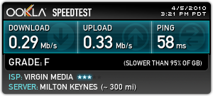

does this mean we wont have IE on pandora? oh and one last time from my trip in europe
TAKE THAT!

x68000 said:
TAKE THAT!
Dunny said:
Muahahahahaha!
Yeah, my upload is actually faster than my download. Take THAT.
D.

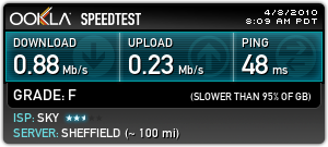

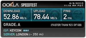

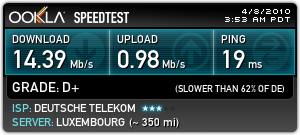

Dunny said:
x68000 said:
TAKE THAT!
Dunny said:
Muahahahahaha!
D.
My upload is also faster than my download :D
What's the competition regarding?
