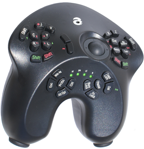

In case people are curious, this is the keyboard he is talking about:
And I agree, it looks like it reads as a standard keyboard, and it works just fine in Linux, so there should be no problem using it with a Pandora.

typs lik dis said:
Is that a keyboard or a 3rd-party N64 controller? How do you type with it?
I just did an image search for the thing; there are buttons on the backside as well. Still not that many but definitely enough to have all necessary keys through either chording or excessive use of modifiers. Given that the thing has three kind of shift as well as Fn, the latter should be the case.
sausage said:
Yes it uses modifiers, but no chording. All keys are present. Type alphagrip into youtube to see the keyboard in action.
I believe you, but the guy in the first vid was annoying to the point that I wish he was present so I could commit homicide.
