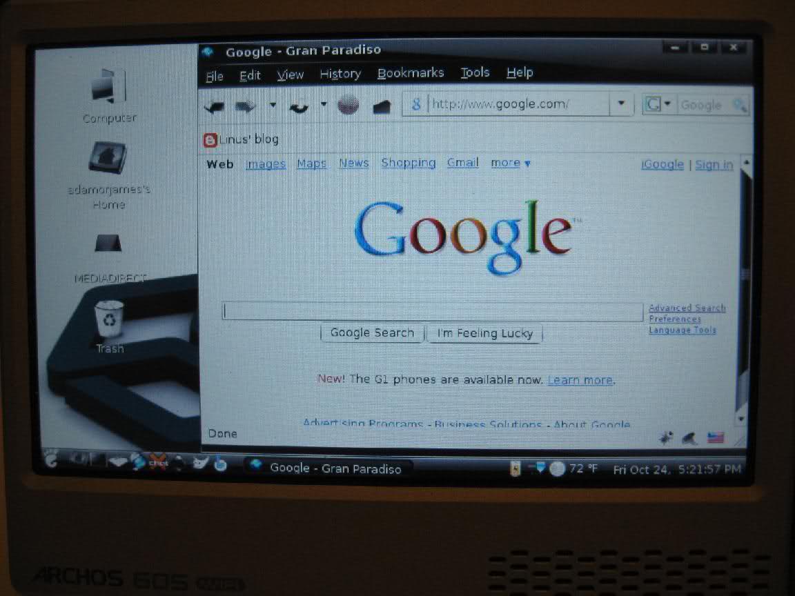

I've very quickly made these size comparison wallpapers, so people can try out various applications that they might want to use on the pandora, and see if it's practical to use. For example, I'm currently using Firefox at the Pandora's screen resolution and it's quite a comfortable fit.

One technique I have used to get a feel for the pandora screen resolution is to use VNC.
I start a vncserver with the resolution 800x480, and then connect to it and launch whatever apps I want.

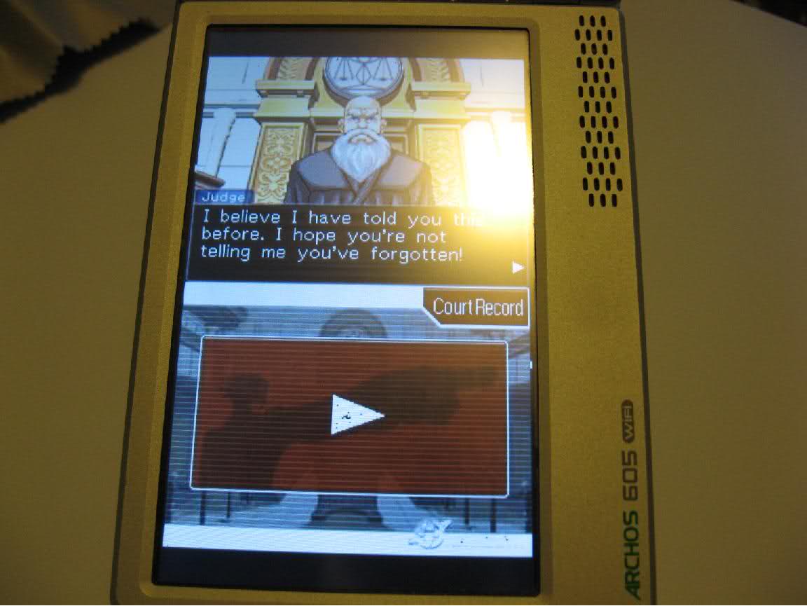

To fix your test, put those screenshots into The Gimp and resize it to 3.69x2.77 inches (355x266 on a 96dpi screen). Here's the last one fixed:
You'd be able to make out the details on the Panda if you squinted, but the sizes are clearly not ideal.
I took that image, put it on my 605, and displayed it in full screen mode. Everything on it is readable, no squinting, and from more than a foot away. I'd take a picture of it if I could find my camera.
