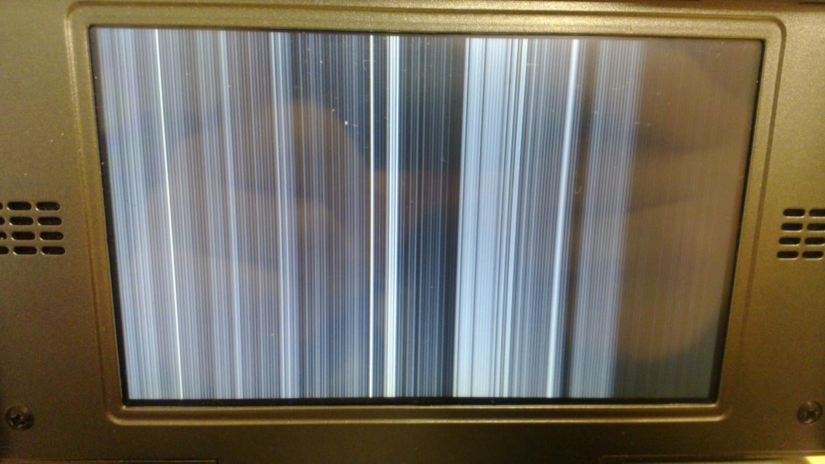

I have a problem with my Pandora and I fear that it is a hardware fault.
What it does:
It restarts very often*. Screen goes into multi-color lines and few seconds later it just reboots. It is very annoying when playing games. Because it removes picture from screen I don't think it is because the CPU. It doesn't matter if it's charging or only battery powered.

Okey I was really lucky that I had the time to took picture of the crash and now I had some more time to look at it. Now I'm sure that it is a hardware problem... If there is no warranty then I need to buy new motherboard. How much it costs? Or do I need to email one of the devs to ask?
These lines arent a problem per see. I also have these when I reboot (well most of the time they are mostly green with other colors mixed in). The problem is the reboot themself...
