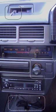

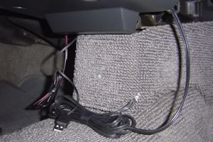

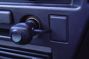

Bumpdate! I should just blog this shit or something. Anyway, I dismantled the dash and ran some cables today, very happy with the result.

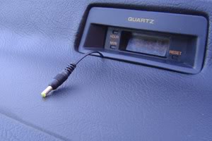

^ In this last one, the 12V lighter power is coming down from the right, and you can see the USB cable (for Pandora power) coming down on the left. You can also see a red/black wire coiled on the left - this is a draw wire, the other end is coiled up the top behind the clock fascia. So if I need to get another cable up there for any reason, I don't have to dismantle the vehicle again.
I just have to re-solder the lighter socket on down here, plug in the USB adapter, then fasten it all up to the bottom of the dash.

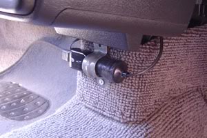

[edit] Socket & USB adaptor in place.
There was an existing screw there, which I couldn't not utilise. It's hardly elegant, but it's neat enough and out of sight when you're sitting in the car.

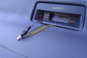

Mounting bracket (version 4) is done, it's a strip of flat metal that comes out from under the clock, and fixes to the underside of the dock ("artists" impression below). When everything is assembled, it's completely out of view. Finally, a decent solution.

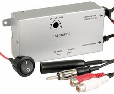

I was in Jaycar today spending money unnecessarily, and found this in the bargain bin ($13):
It's an FM modulator, which basically allows you to feed a stereo RCA signal directly into the antenna plug of the car stereo. It hadn't occurred to me that these things existed. It won't suffer from the interference problems of a regular FM transmitter, and it also saves me having to upgrade to a Bluetooth stereo. Win!

Damn, that's cheap! I'd be a little concerned about the quality though. Anyway, I think I'm happy with my $13 spend. ;) Saves me having to install a whole new head unit too.
