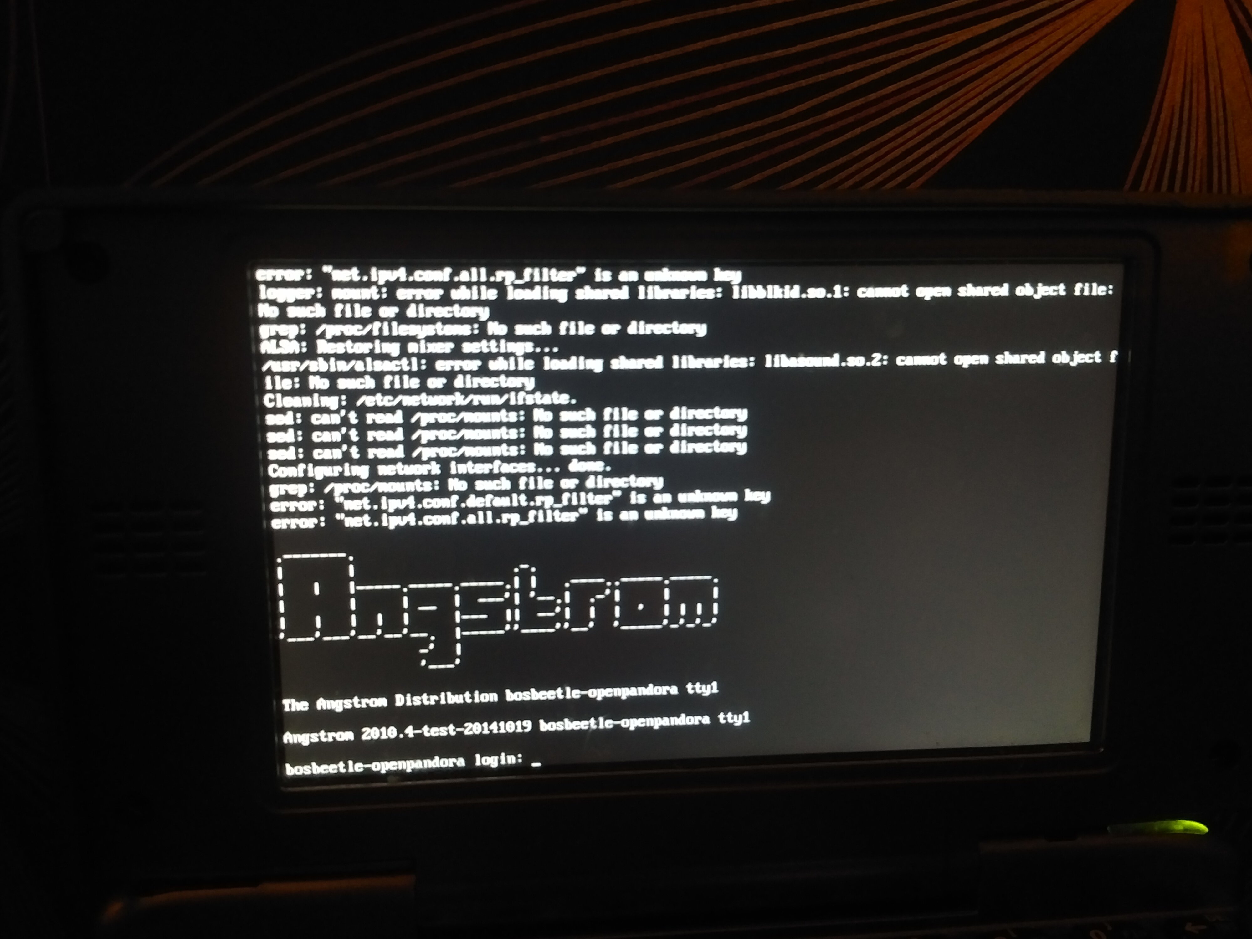

But now again it started to boot into tty1, there are some messages that some libraries cannot be found. It asks for a login, but it doesnt login with my password. Is there a way to get from this tty1 environment to the regular os?

These are the errors it seems it cannot mount something.
Any login attempt results in the message: /bin/login: error while loading shared libraries: libpam_misc.so.0: cannot open shared object file: no such file or directory
From my reading it looks to me like it failing to find a lib named libblkid.so.1 which is probably related to mounting judging by the name. That could break things and suggests to me something you're running has been built with and older version of the OS, i.e. you've got a bad flash, assuming you've not got the source for things and rebuilt them yourself.
But why would that trigger after i've been using it normally for about half a year? And not installing something new, let alone building someting.
The image i used was from here.
I don't really know. I've never experienced yet (touch wood) and kind of spontaneous corruption that would cause that, but theoretically at least some kind of file system corruption could cause that (although I personally would suspect an aborted reflash if you did nothing to fettle with that area of the filesystem). That sort of thing in mainstream linux can result from a selective OS update, or the administrators pushing an old build of something to the repos, or you manually trying to use an older build of something to get over a software error, most likely in my experience, but during my use of the Pandora I never had to result to that.
