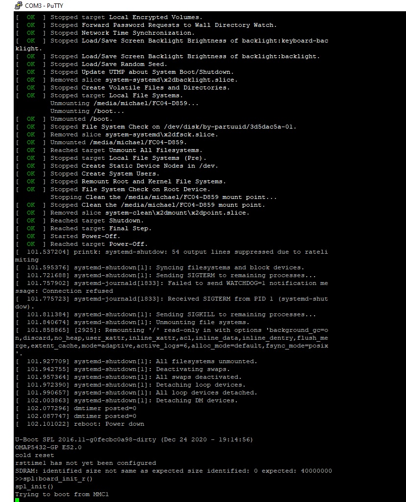

Can you connect some PC through an µUSB cable and run a terminal program to watch what the serial console is telling during boot?

@hns I did that but I am not sure about the UART parameters, since I receive only rubbish. Are they U-Boot specific? I tried

I only receive 5 or 6 digits while powering on with the SD card.

Yes, that looks good.
What do you see if you boot from the eMMC?
I managed to get readable output! The upper part is from shutting down the OS from the eMMC and the last 8 rows are the output when booting via SD card.
Ok, it looks as if your board may have different RAM chip setup parameters when booting from eMMC than on the SD card and therefore the U-Boot from SD does not properly initialize the RAM.
This could explain why it worked once: you just were lucky.
I am not sure what the solution for SD card boot is, but I remember that ED may have different versions of U-Boot to install. There could also be a fallback if no U-Boot is on the SD card but I do not know what has been done execatly by developers of the PyraOS.
