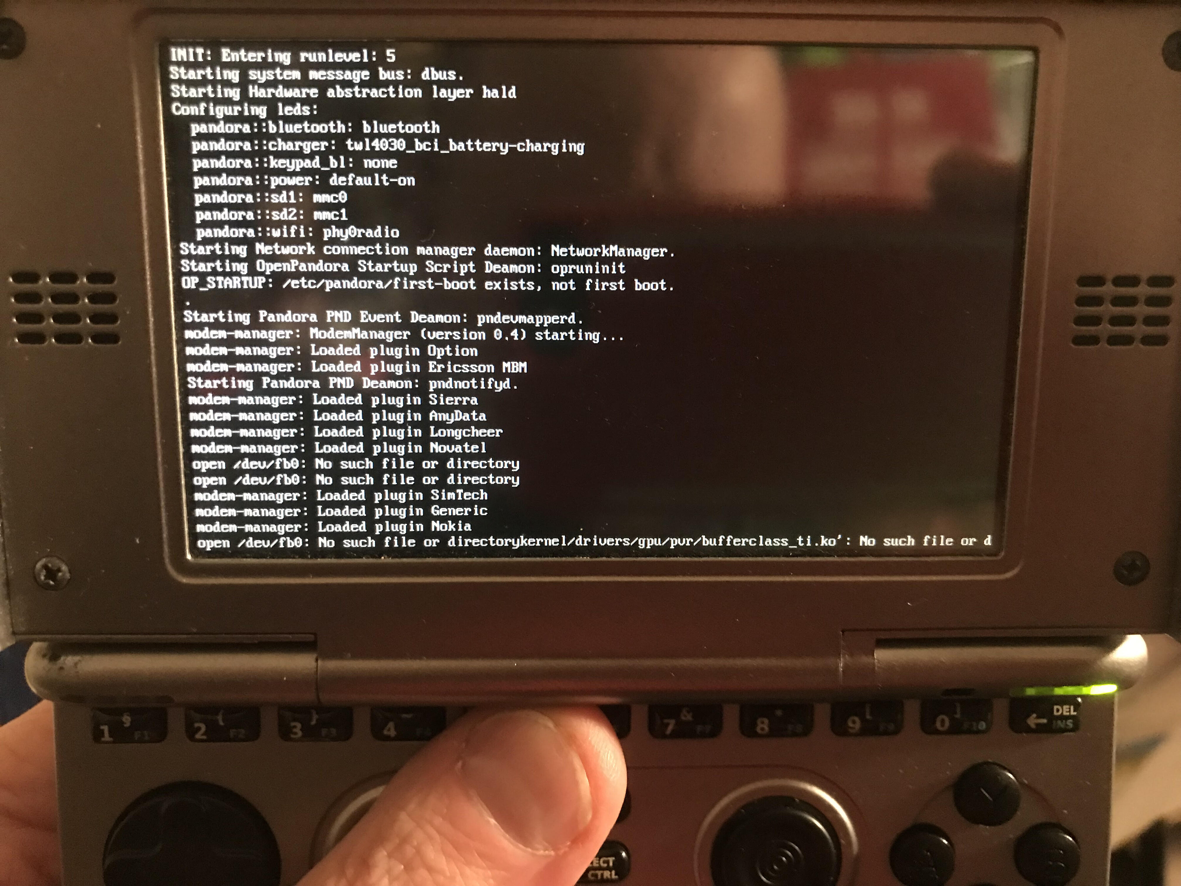

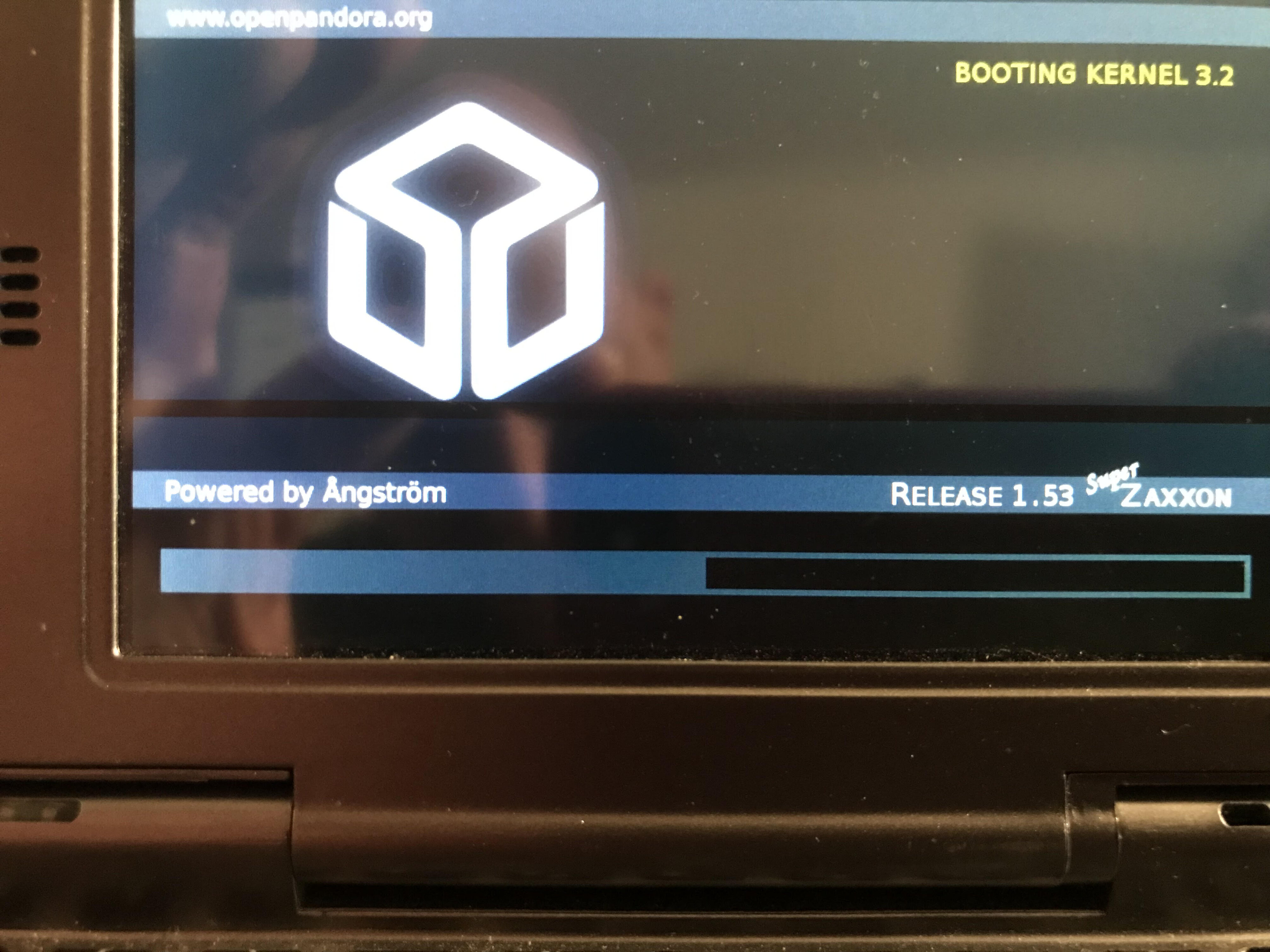

Since then I'm unable to boot. The bootscreen's progress bar would get to the last centimeter (attached photo is from a few seconds before getting near the end and hanging), and then go an error screen that I've attached to this post. The only way to turn the system off is to remove the battery. After multiple tries to reboot (having to drop the battery out each time) with and without the boot SD card, now when I turn the system on it only gets as far as the boot screen and hangs on that last cm of the progress bar. No error screen.

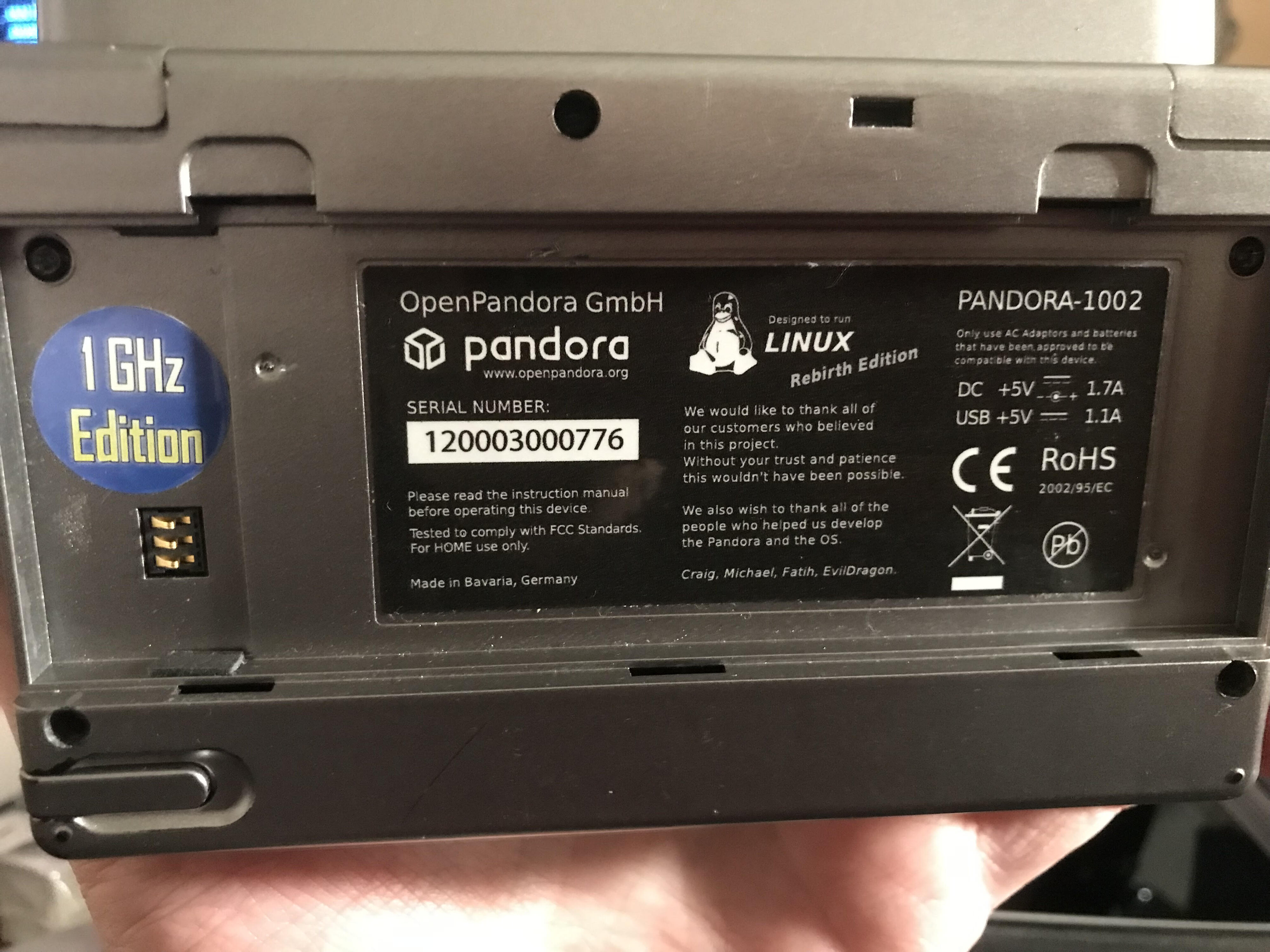

Looks like filesystem corruption to me. Might not be related to your switch repair at all, just a coincidence instead. It shouldn't take much investigation to find the reflash instructions around these parts.

I hadn't used OP for a while, now when I turn the system on it only gets as far as the boot screen and hangs on that last cm of the progress bar. No error screen.
I once had that issue in the past and, from what i remember, it is caused by a bug of the latest SuperZaxxon (v. 1.76 i think). In my case that issue occured when, by accident, i choosed to "Log Out" before power off my unit. The next time i powered up my Pandora the progress bar stopped before reach the end like you described. So, remember, never hit the "Log Out"option on the "Shut Down" screen whenever you want to power off your Pandora. To fix your issue you have to reflash your unit, that's how i solved it.
Unzipping the 1.76 firmware now. It says it's gonna take 40 minutes? Seems like a long time for such a small file. :p

My hats off to all of you for your friendly and rapid help that even I could follow. ;) My Pandora is happily buzzing again, thank you. I'll have to check the SD compatibility chart and see if I can pick up a couple cheap 64 Gb cards to keep things humming.
It really is a brilliant system! I'm not as deeply computer savvy as a lot of the users of the OpenPandora, but I can appreciate all the smart touches throughout - and awesome resources like this message board. Plus I was able to use the input tester to see that my RIght trigger button isn't as fixed as I thought (I was able to reflash the firmware without the trigger thanks to the instructions you guys pointed me to create that Autoboot.txt file. THanks a million for making this a simple process!
