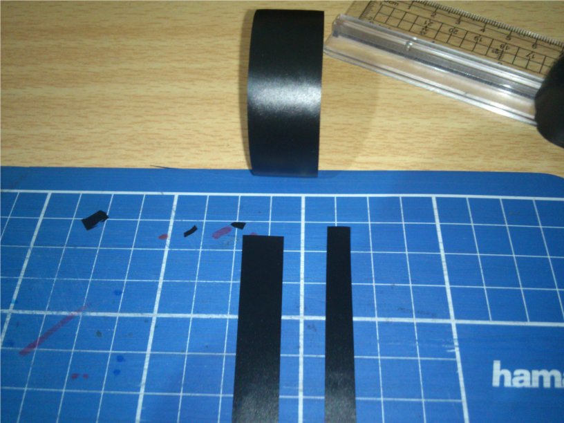

Just cut a strip of the electrical tape to the length of the hinge. Ordinary tape should have a width of 1.9mm, which is just perfect for this mod.

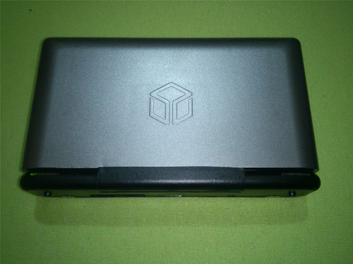

You need two layers of the tape. Just stick them together and than stick the whole strip on the backside of your Pandora's lid.

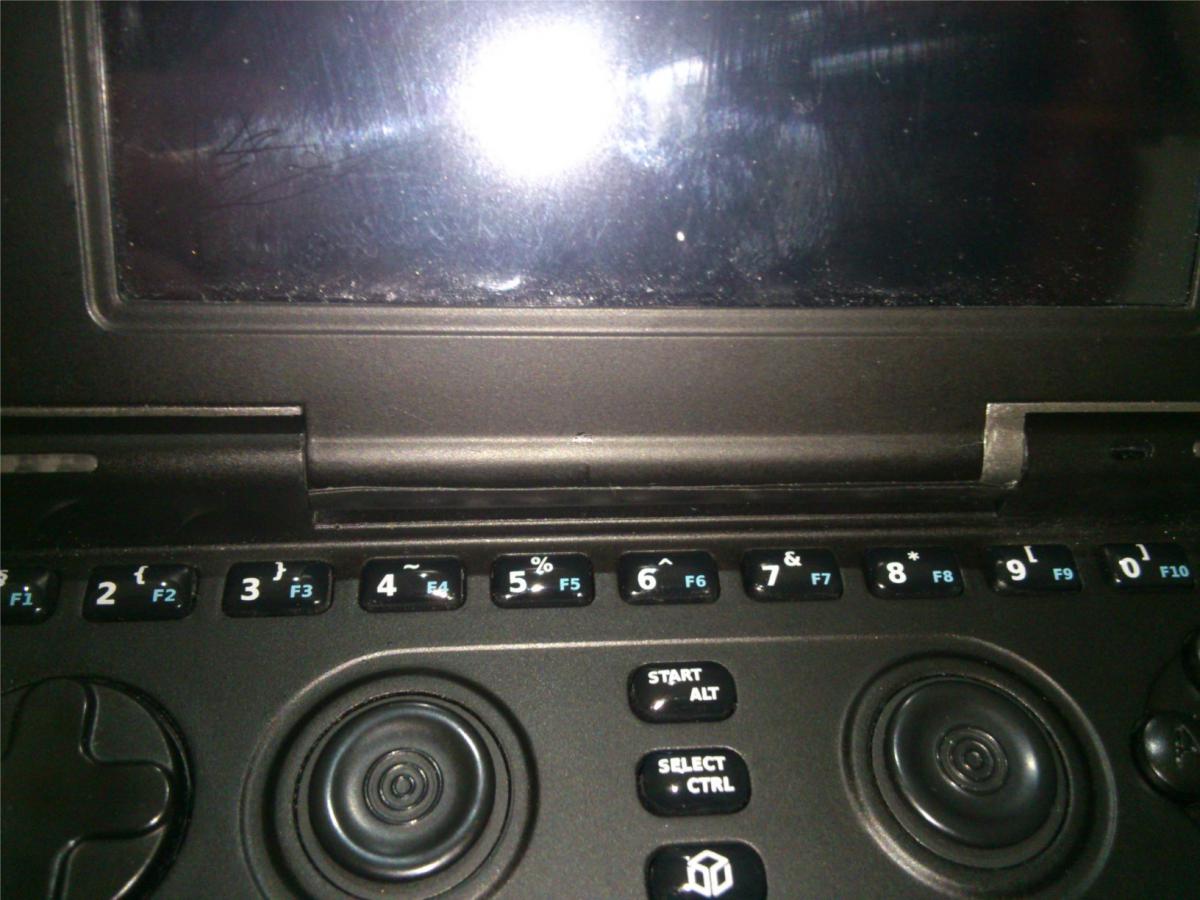

For even more friction, take a third strip, but make it just 1/3 as wide.
Lift the tape on the lid a bit up attach the thin strip underneath. Place it on the upside of the Pandora.

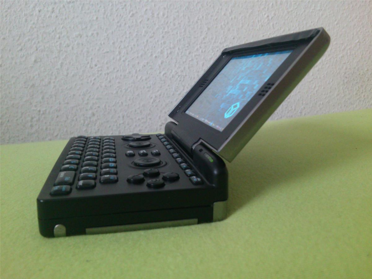

Now your lid is not that loose anymore and it has a perfect laptop mode.
