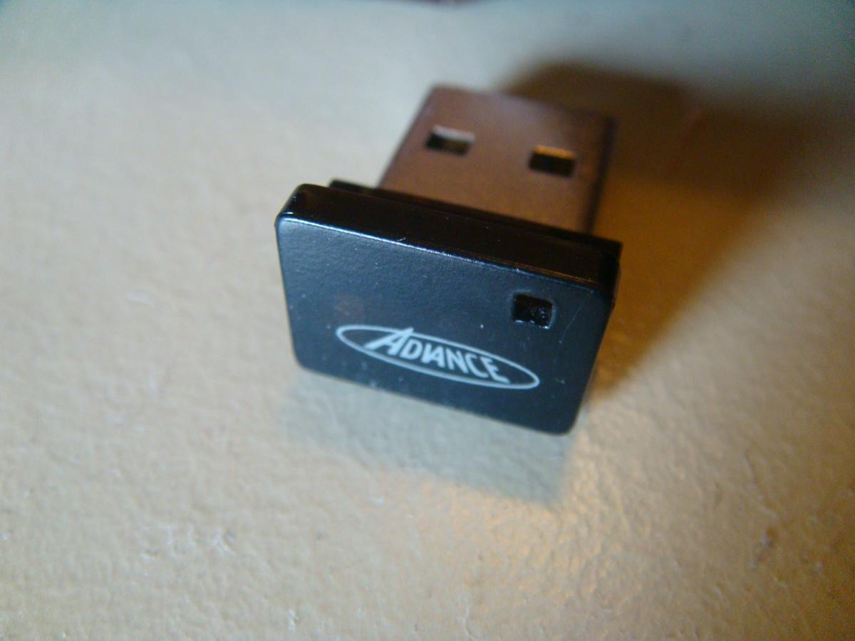

Here's the Advance one.
With the little hole, it's possible to attach it to the OP.
