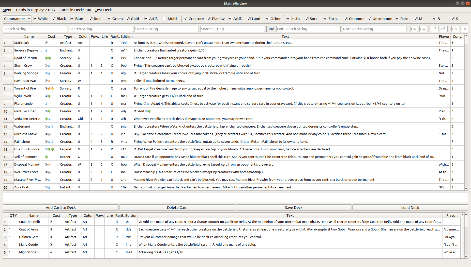

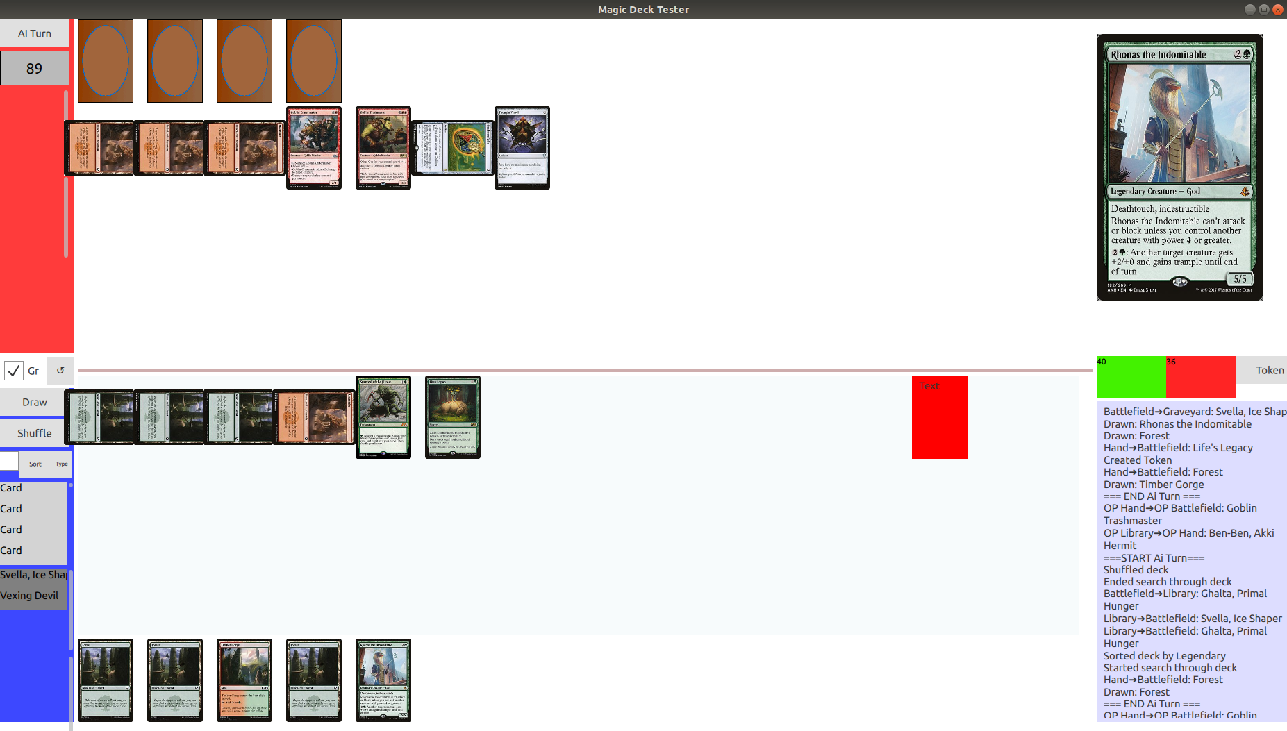

I wrote a magic the gathering deckbuilder and a deck tester. You can play against a (stupid) ai, create your own decks, print proxies and filter by color, type, string, not string and rule set (commander, modern, etc). It is opensource but yet unreleased. I could use beta tester, bug hunter for a nasty deck builder bug and maybe co developers for replacing the AI with network code for team play.
Is there interest in this software from the pyra community?
It is written in pure qt/c++/qml and has only qt as dependency.

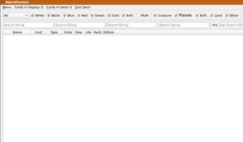

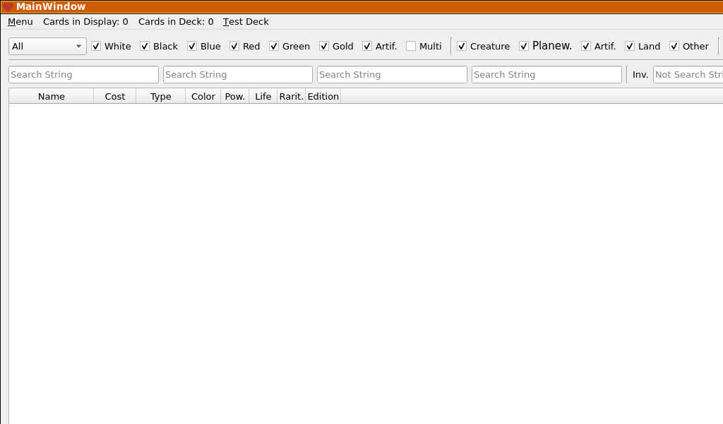

Can you post a screenshot how it looks like on the Pyra?
I don't have a Pyra, but I'm testing this on my eeePC which has a slighly lower resolution than the Pyra does, (1024x600 versus 1280x720).
I had previously unpackaged and built testproject-master since that looked the more promising name, however that builds a project called cute_magic. Qml_master builds magicnet, but that doesn't run for me, and debugging in qtcreator leaves with a debugger exits code 377.
But in any case, cute_magic looks like this:
Cutemagic is a deck the building software. You need to download cards.7z and unpack it into the build directory of the cute_magic
Magicnet is the decktester. It needs as first argument the path and name of the player deck. It uses for the AI aigobo.deck, which needs to be in the same folder as the player deck. You download premade decks from the post. Sorry for making it so hard to install and test.
