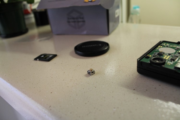

Photographing the damage would require me to open the pandora. I could take a picture of the button thing that fell out though and post it tomorrow, but I am pretty sure there is no confusion about what that is.

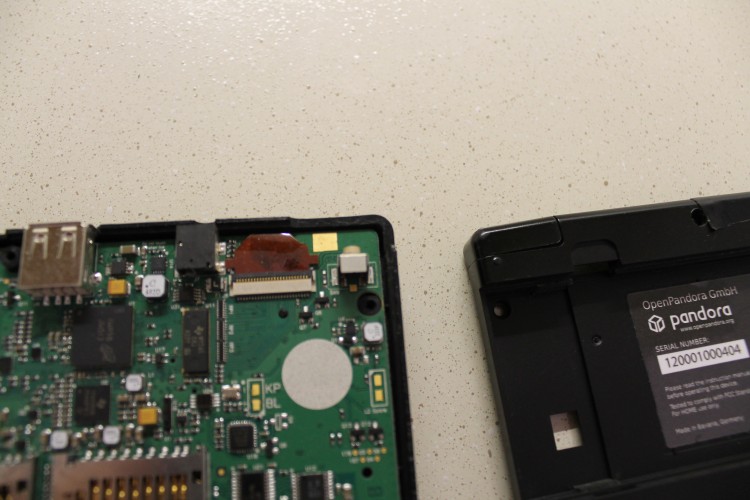

A picture is needed. If the pads that the button was soldered to are still intact, then it is possible to solder a new one to the board. If the pads are damaged, there's isn't anything that can be done.

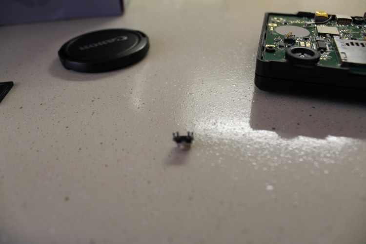

Ok, so I will post pictures of the button part and the inside where it connected. I would definitely need a new button though, because it seems jammed (the actual button that fell out), if that's possible. In the event that it cannot be repaired would, however drastic this might seem, replacing the whole board be practical? As in, how much does that cost?

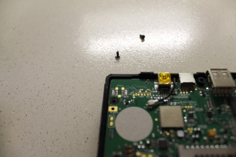

Here are the pictures. I threw in a picture of the left button for comparison. Obviously the difference being that it's there and the right one is not.
So what's the verdict? Can my pandora be fixed?
This looks like an easy solderjob for someone experienced with an iron. You need to get the button though as it seems to be broken off.
I'm not talking about the black button externally, I'm talking about the piece that broke off. If that's not clicking, then ???? I have a unit sitting here with a dead shoulder button due to the button internally not clicking. I don't know if this is a solder job or what needs to be done. I would consider this a 2nd level repair and see if you can get it to ED unless he chimes in here otherwise with a fix.
Yes I am talking about the actual internal button. It does not click. If I need to send it to ed thats fine, but I do need a new internal right shoulder button.
