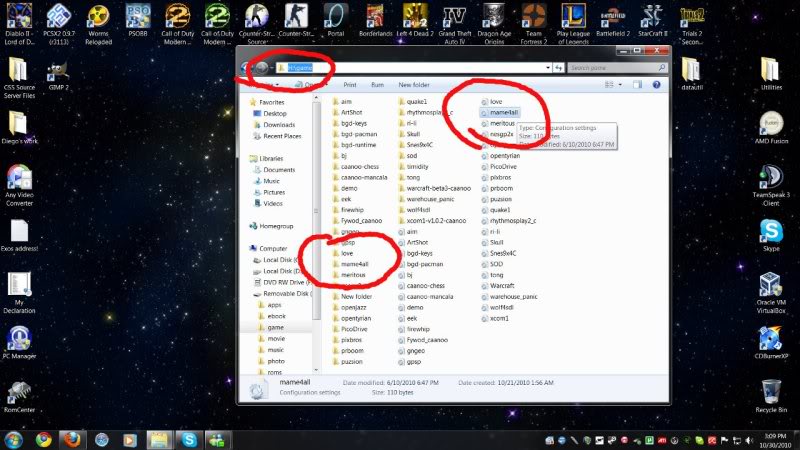

make sure that the file structure looks like this, create folders with these names if necessary.
at the root of your sd card create a folder called game, now copy the mame4all.ini (configuration file) into the game folder. Now drag the Mame4all foler into the game folder as well. I have uploaded some pics to aid you. (i know its not a mac but it should be the same except for maybe the drive letter).
First the game folder

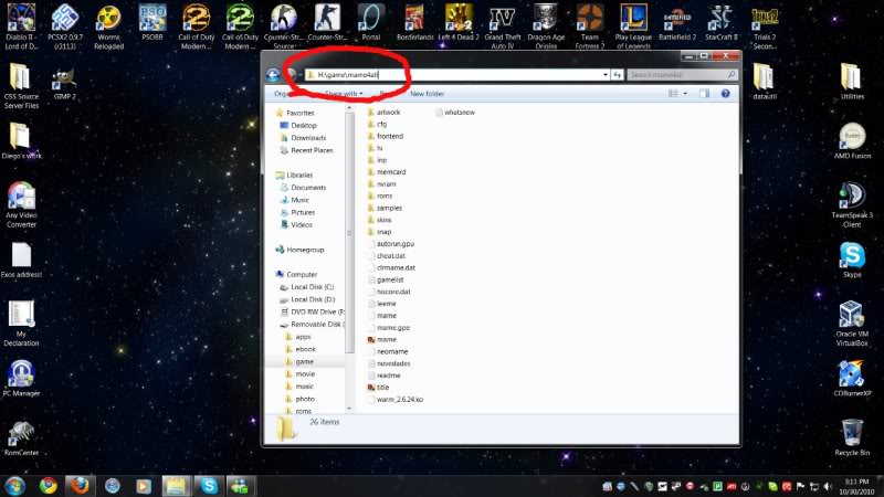

Now inside the mame4all folder it should look like this. Pay attention to the file structure at the top (circled in red)
and thats it!! As long as it looks like this it should run. The operating system (MacOS X) shouldnt make any difference at all. As long as it can read and write to the drive (caanoo) that is all that is necessary.
