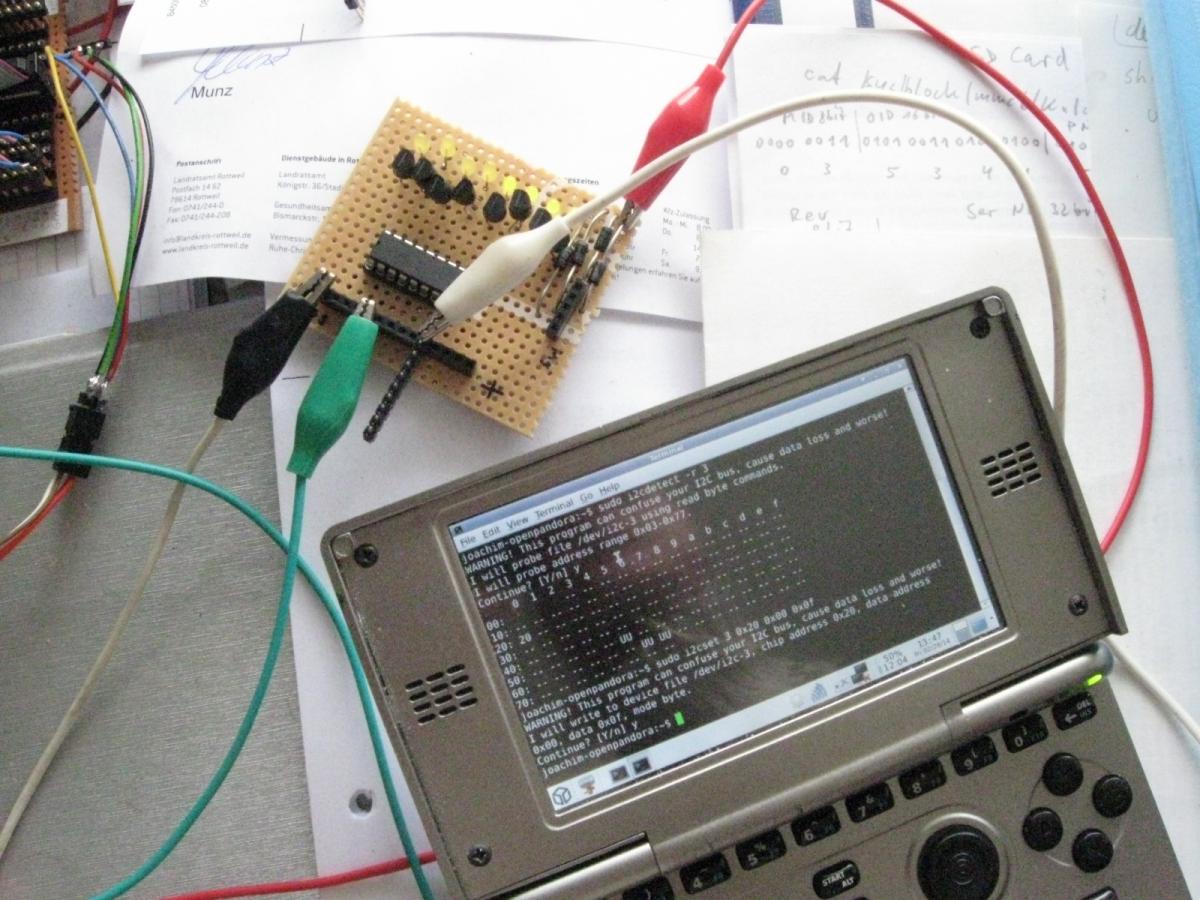

thanks a lot; when I try with i2cdetect I get the message "cant use SMBus Quick write command" and the -q -r etc are not recommended. Info is shown with -l. So far that is what I need.
thanks again
tried with -r and got 55,66 and 67 so it works well. I hope this didnt kill anything.

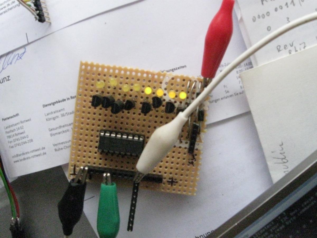

as you can see i2c is working so far from shell (8bit I /O)

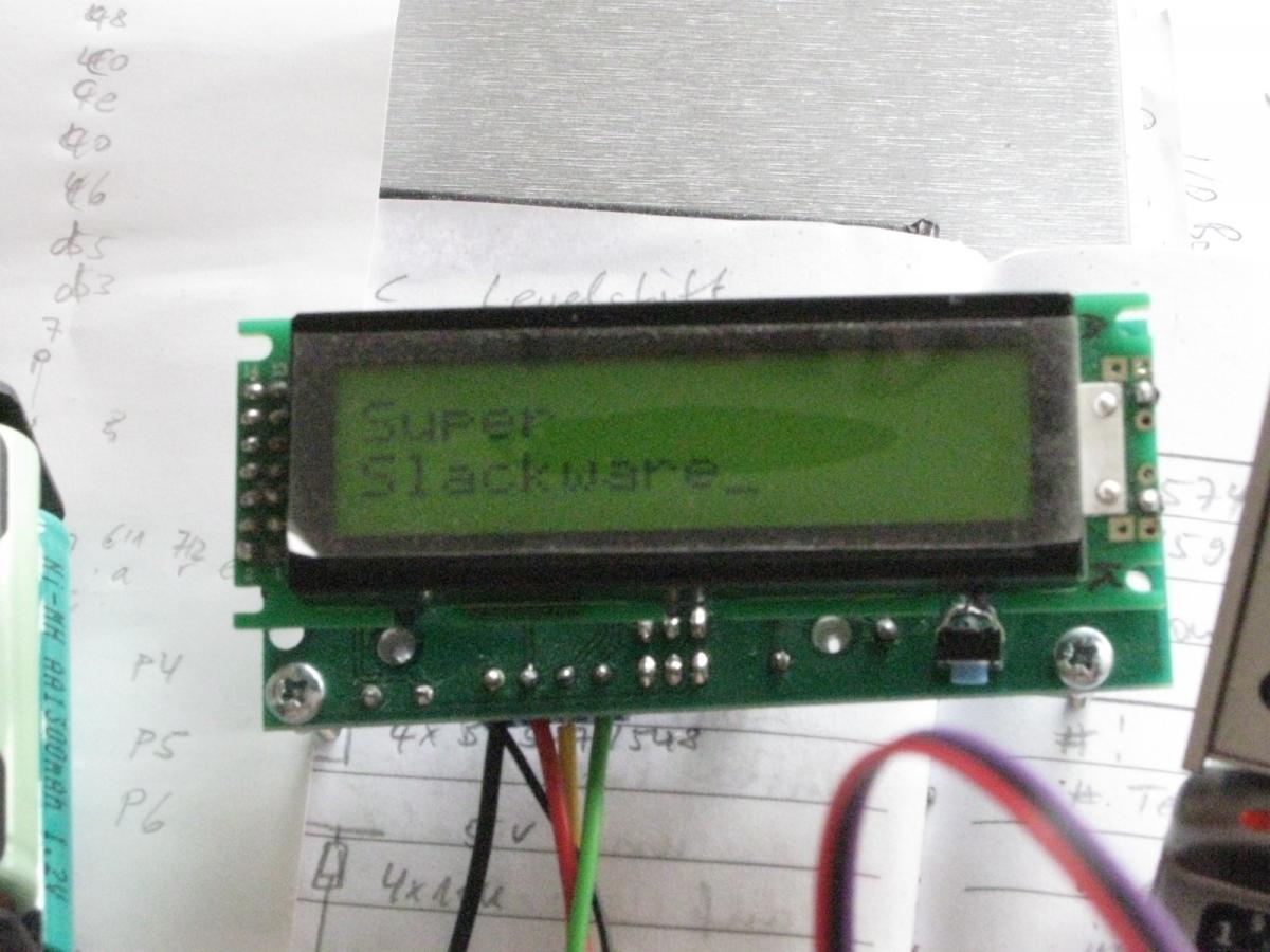

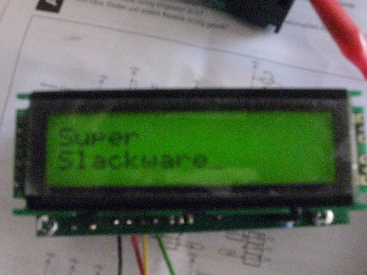

here a LCD with I2C direct from Pandora programmed in Python :
OS Slackware
Cool !
Upload as many pics as you can ^^. Do you have some with the OP mobo connected ?
First I built a level converter because the LCD is 5V but after thinking I removed it because SDA and SCL are open collector and it worked without. Here the whole thing.
