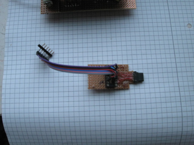

first the ext adaptor

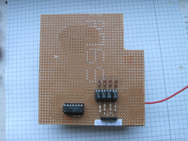

then the parts left is  a 7bit counter 4024, right 4x optocoupler SFH 620

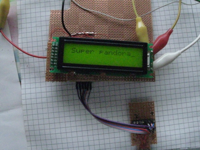

last is LCD with test out
@thatgui  this was just as a proof of concept for switching the GPIOs and output on LCD, but maybe later I can use this for showing info when the lid is closed (maybe a clock with alarm and a beeper for alarm). Another idea is an info terminal for home control i.e. temperature control.
Interesting. I wonder why you used optocouplers rather than the transistor-based buffer design that I'm more used to. I can't see any downside to your design - bandwidth should be high enough and I guess it gives you better isolation, but it's new to me, that's all.
I've used optocouplers long ago with the input pins of a parallel port interface I made in High School... but I think my Electronics teacher thought I'd blow up the computer.
@ LEvi:
this was just for isolation purpose, in case there is a short circuit while building the prototype or while measuring so I won´t kill something of the pandora. "It´s better to be safe than sorry" ;-)
