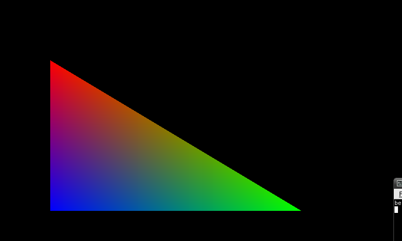

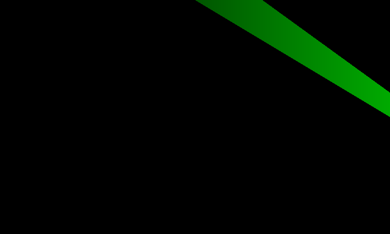

For openGL, I use SDL with flag SDL_OPENGL flag, for openGLES I use EGL.
Result are attached, first one is openGL and second and correct one (I guess) is openGLES rendering.
The OpenGL ES one is working as expected, right?
I think your problem is that in the OpenGL version you redefine GLfloat to GLdouble, but you still pass GL_FLOAT to glVertexPointer. So it's interpreting your doubles (64-bit) as floats (32-bit). You should pair GLdouble arrays with GL_DOUBLE, although I don't see why you can't use GLfloat with the OpenGL version, nor any of the other float functions.
Nice eye, Exophase, that was it!
That's the problem with first steps, I just assumed that part from the GL->GLES porting tutorial. I really need to better understand what I'm doing :)
Thanks!
