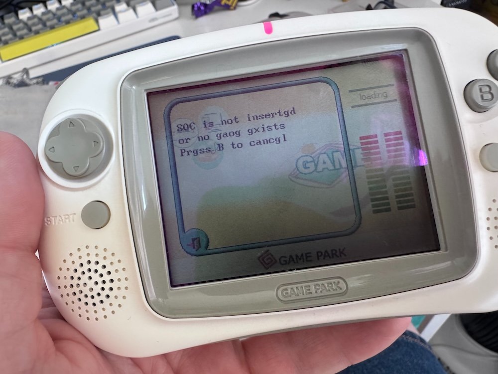

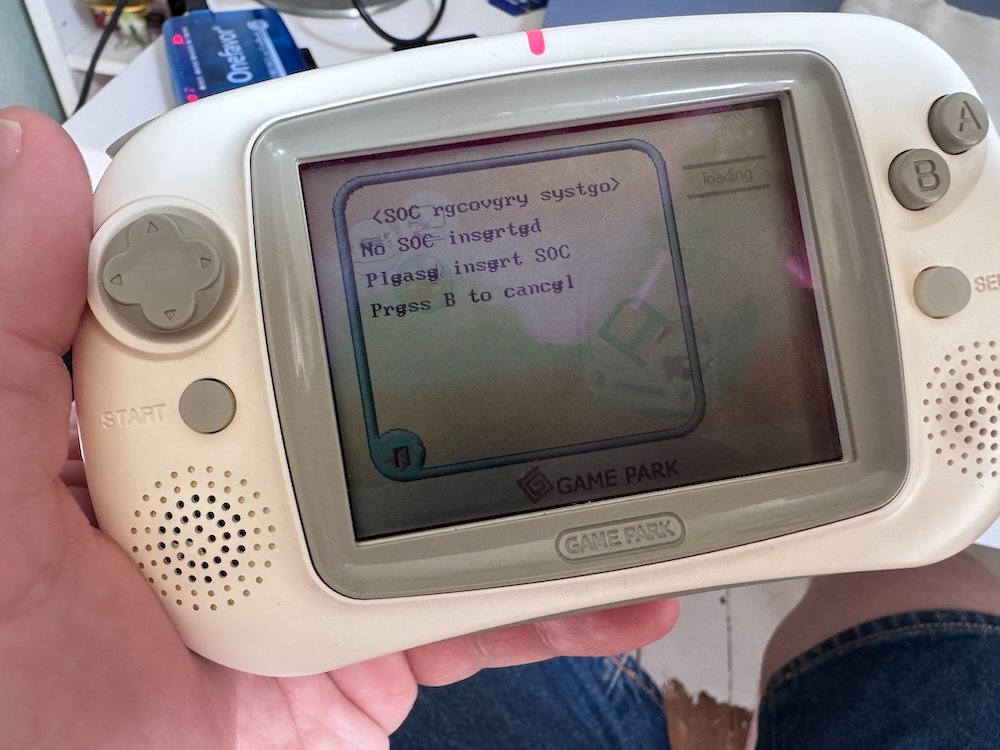

Sorry to revive an old topic, but in a fit of nostalgia, I decided to pick up a GP32 off eBay, and I'm having some issues.
The device boots into the Game / Music etc menu fine, but won't read either of the SMC cards it came with. I get an error with garbled text ('SOC is not insertgd').
I've put both SMCs into a USB card reader. One cannot be read, so I assume it's dead, while the other had emulators on it. I've formatted that using my PC (which I now realise may have been a mistake) but it's still not recognised when I insert it into the GP32.
Are the SMC cards at fault here, or is the console faulty?
Any help would be amazing.

I think you can read SOC as SMC for a start

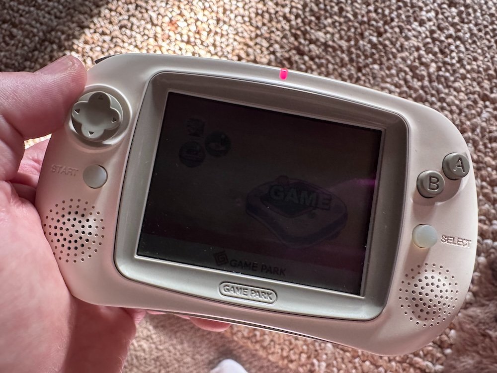

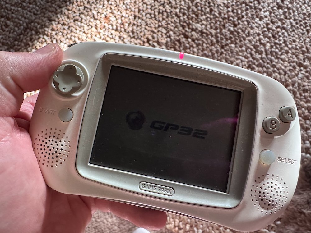

I would say to me it looks like a corrupt firmware issue - can you send a pic of the console as it's just been turned on?
Post automatically merged:
and the file system on the SMC
Firstly, thanks so much for replying!
I've attached two photos - one is the boot animation and the other is the main menu.
I've backed up the SMC and, when I'm next at my computer, will send you the file system. It's literally been two decades since I used one of these, so are there any basics I'm missing when it comes to files / folders I absolutely need to have on the SMC?
Thanks again!

That is strange, would've thought it was flashed with a multi+firmware from the screenshots. Does your card have a file called freelauncher on it?
Having dug through the forum I think it's a freelauncher issue... Not sure why the text is garbled but would point to that.
The original console was locked to play just the game park original games. They then "unlocked it" by creating a freelauncher. Each freelauncher is tagged to the system so...
Whatever you do don't format the card until you've checked this... If you find it save it to your computer.
If you don't have one I remember there is a cracked freelauncher you could use. It's need to work out how it works and if it will run still in win 10+ systems.
It's it a non lit unit?
Sorry for the delay in getting back to you on this!
Yes, it's a non-lit unit.

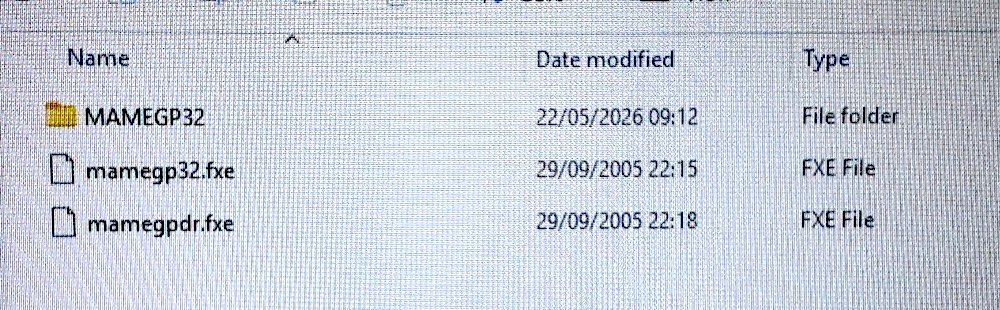

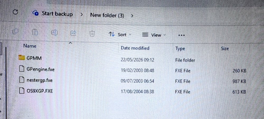

I've actually formatted the card that it came with (I knew I should have waited!) but I saved the contents to my desktop before doing so (see attached images)
I really, really appreciate your help with this – even if we can't find a solution!
