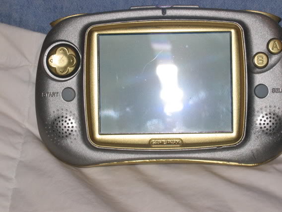

Well, I finished it, gave it a new coat, and popped it back together and thought you lot might like to see. I like it, personally, and now the colour is all even. the cool thing is that the gp32 kept it's original texture, and is not shiny at all. One annoyng thing though, is that i took of the label on the back, intending to restick it later, but it disappeared. Oh well, here is the pic, sorry about quality.
Wish i'd got a silver for the buttons and stuff though. I'll do that some other time.
As long as it came out even and you're happy with it, that's all that matters :) I'm surprised that it kept its original matte texture, good job on that! Now watch out for them chips!

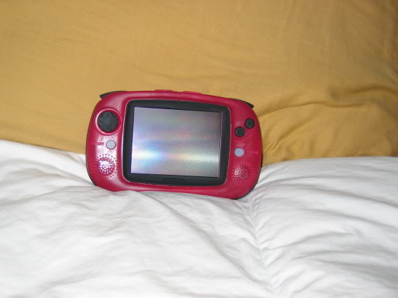

pshh. This is how it's done
and
:p . Im just messin with ya. Nice job with the blue, that was supposed to be my original BLU+ color but I changed it to the red/black the last second. If your happy, then I say you did a good job :)
DCGM, I realy like the dark red w/ black framework paint job. It looks complete.
