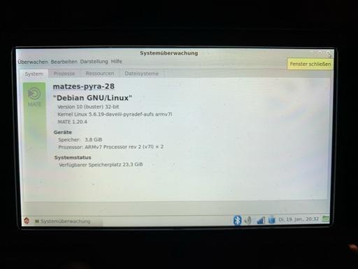

Ok so this means when I made the upgrade of the test 33 image whit apt upgrade, it’s in the end the same OS I would have when I would apt upgrade the OS who was on the Pyra 28 when it arrived to me last Wednesday?
Im just a bit confused because the blue light that was back who was gone last weekend before I had to reflash..
Not send from my Pyra, but my Pyra is also here whit me ^^
Yes, although there was a delay while you played with the system and observed the colour of the light, and then a delay while you reimaged the filesystem, and a delay while you observed the colour of the light again. Any lenght of delay means there more of a chance somebody will have published an updated package on the server, which you then install when you do some kind of apt* upgrade.
Ok and what dos this means for someone who only got user experience whit the Pandora and a bit Ubuntu User Experience?
I know how to drive everything from a E-Bike over Scouter, Small Cars, Vans, SUV up to Unimog and even Busses, but the Pyra is something like our Kanzlerin Angela Merkel would called „Neuland“
Would my Pyra gets ever come back to the state of the other Pyras on the Wild?
This is a bit sad because I wanted my Pyra extra Maxed out because my Pandora is a First Batch Unit whit less MHZ and less RAM than a Rebirth..
Edit: is this the right version anyway?
As long as we're all updating like good linux users should, we'll all be on the latest code.
