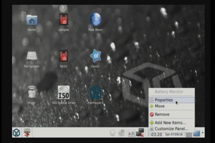

Hi is your Pandora not blinking a red Light when the Battery runs under 10 Percent?
[doublepost=1468093179,1468092779][/doublepost]Here are Pictures where you can set the Battery Percent for the blinking Red Light Warning:
Maybe them Help you :D
I don't think those numbers affect the red light. If I plug my Pandora in as soon as I see the light, the low battery message doesn't appear. There's probably something in /usr/pandora/scripts that sets the flashing light at the appropriate time, but I've never investigated myself.
Oh.. I switched off all sort of LED stuff with Notaz's latest firmware, maybe that's why I missed any flashing red lights. Or I was too busy playing to notice. ;)
The Live System info PND works great (with Opsu atleast) as it's an overlay so it would have to be something like that but smaller and with less info.
Check the Parameters in /etc/pandora/conf/eventmap, bbut because it shuts down Automatically these seem to be correct.
Ah i think i have the right Idea for you.
In my second Picture you can set a custom Command when the Battery goes low.
set here:
Code:
pnd_run /path/to/your/sysinfopnd/sysinfo.pnd
And everytime when the Battery goes low then the Sysinfo will Appear.
You can set that Sysinfo appear with 5 Percent Battery Power :)
