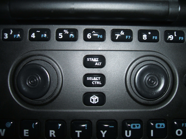

EDIT: It just occurred to me to provide a photograph of what I'm talking about. Here it is;
As you can see, it's staying in place even though both of my hands were on the camera. I also forgot to mention that it doesn't go all the way to the top like the right-hand nub does - it seems to get "blocked" from doing so a little over halfway to the top.
