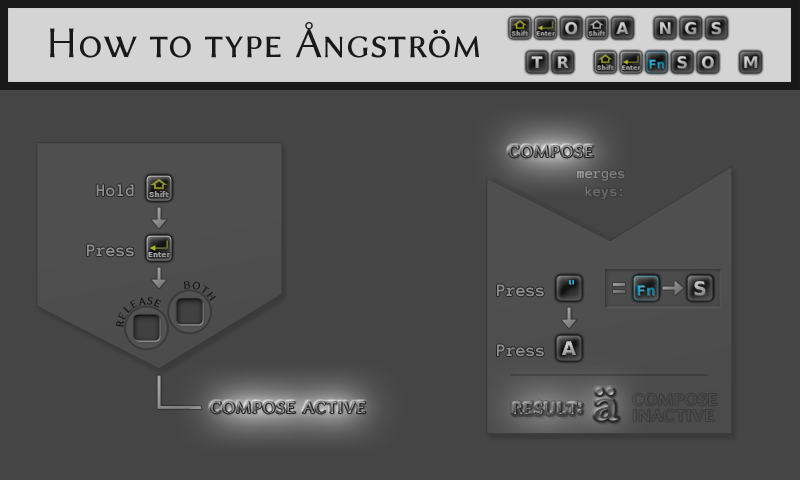

Or ÅÄÖ buttons for nordic people?
Cant write in my two motherlanguages(finnish and swedish) since i forgot how to do ÅÄÖ.
would need to tape a small booklet o to my panda with good things to remember
If you want, you can use this image (originally from this source post) as a wallpaper on your Pandora, and maybe you will know by heart sooner or later.
Thank you!
