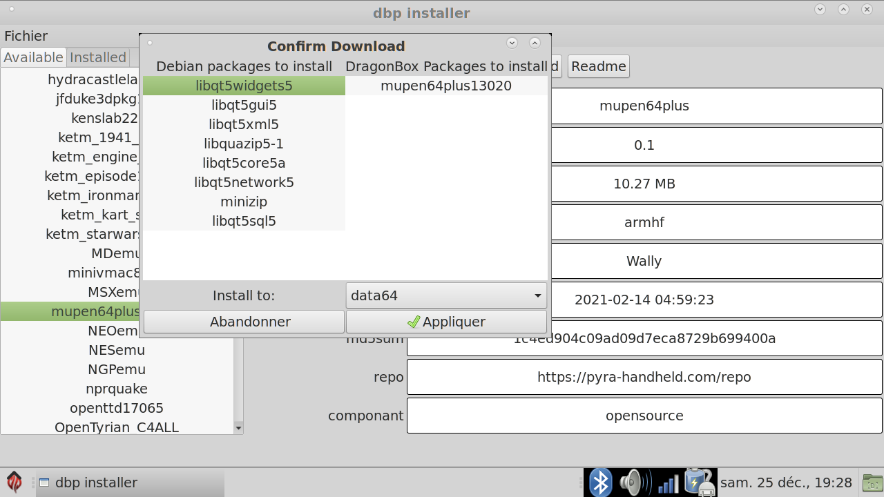

This is a very crude Installer for DBP.
[ repo - sources ]
As the license suggest do what ever you please with this. I hope someone will come up with a proper repo frontend, but this should do until then.

Just added a command line interface :
Code:
usage: dbpInstaller.sh [-h] [-i pck [pck ...]] [-d dest] [-u] [-U] [-l] [-I]
install DBP packages.
optional arguments:
  -h, --help            show this help message and exit
  -i pck [pck ...], --install pck [pck ...]
                        Install the packages from a list of package id
  -d dest, --dest dest  SD-Card to use
  -u, --update          Update the cache
  -U, --upgrade         Upgrade installed packages
  -l, --list            List known packages
  -I, --installed       List installed packages

Hi all :)
@sebt3 : is updating DBPs currently supported ? I have 3 of them in updatable state (yellow) in dbpInstaller, but clicking on File > Upgrade installed package or manually selecting each package then clicking on the Download button doesn't appear to be working...
Am I doing something wrong ? I'll try to have a look at the logs, see if I find something interesting.
EDIT:
Code:
Traceback (most recent call last):
  File "/mnt/dbp/union/dbpInstaller_sebt3/dbpinstaller/ui/installerui.py", line
207, in on_update
    self.installer.get_packages_list(),
AttributeError: 'DbpInstaller' object has no attribute 'get_packages_list'
