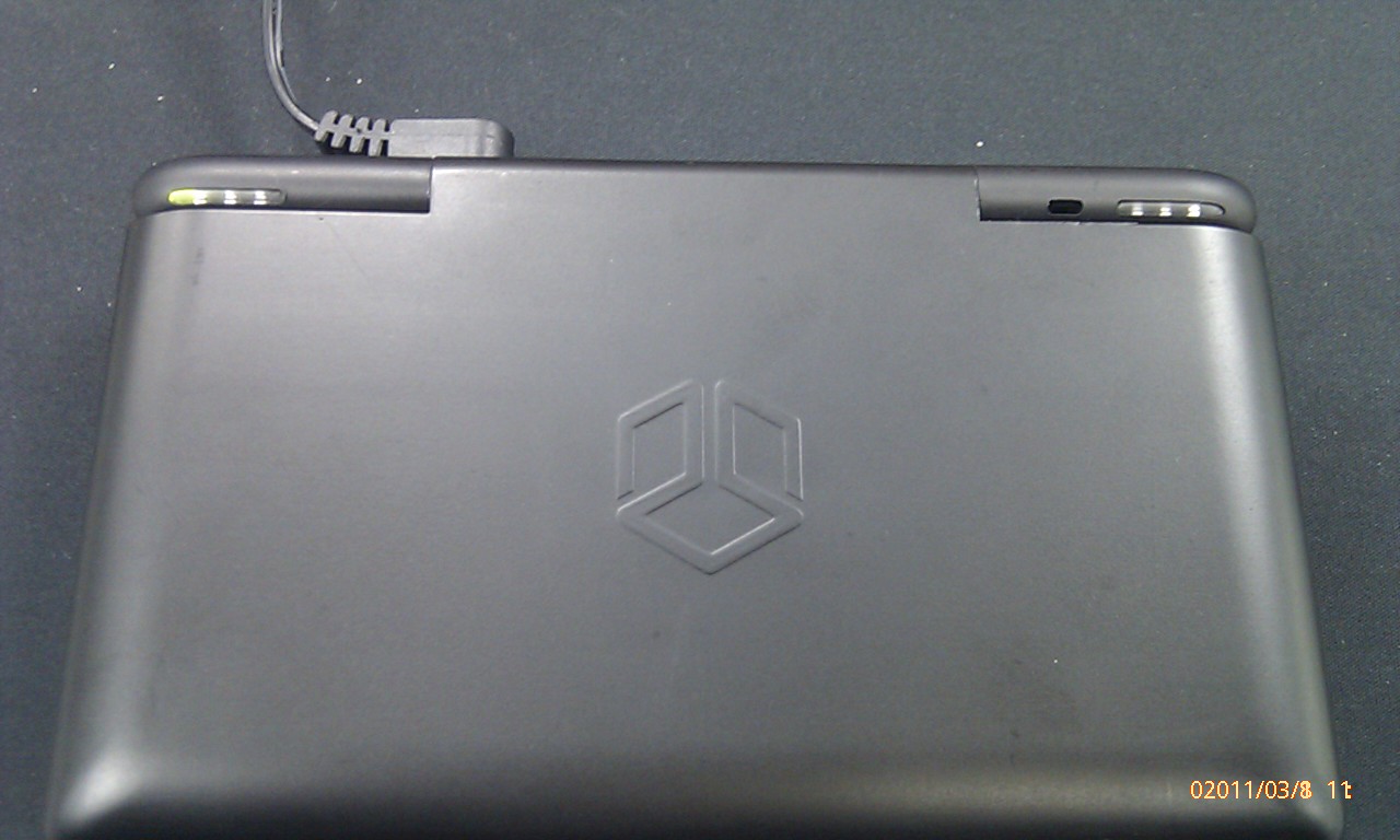

Hey Lucifer and All,
Not sure if anyone's still looking at this but, I guess I encounter the same thing as Lucifer and, my situation is even worse.
Yestday I finally got the delivery which was ordered in late 08(familar huh?), only to get the box with the left-most green LED on when plug in the power cord or place the battery. Attached a phone showing how it looks:
And that's it. Nothing displayed on the screen. However I try (reboot-R key, press "Cube" key + Switch, ...), I didn't see anything changed. Not a twinkle to see anything in the right side.
Maybe Lucifer is only experiencing a poor contact issue, but my box is a complete failure.
Folks, any suggestion?

Sorry to hear that. I feel your pain. Mine is on it's way back to OP now.
Sounds just like mine was behaving except that I was able to power up occasionally.

Looks like in my case going for OP is inevitable too.
I've tried the suggestion above, which was mentioned in this thread:
And it doesn't work still.
Is it possible that directly send it back to OP UK rather than back to the original distributor?
Because I placed this order with help from my friends in US, it seems not wise to shoot it over pacific sea to US, and then from US back to UK.
