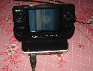

i hav gp2x-f100,
when i plug it with cradle, gp2x wont boot......
it stuck with white screen......
can anyone help??????
we4r.sirus@gmail.com :(
all i've got is this when plug to cradle.......
somebody plz HELP me......
is it cradle problem, or wat??????
