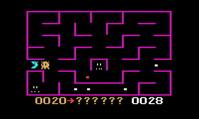

Tried to compile another program today http://o2em.sourceforge.net/ used source 1.18 file. We already have a version but it lacks savestates and the version from ED doesn't work at all so seems like a good candidate to try it out. I'd rather spend some time learning while compiling something useful as well :)
It doesn't have a configure file so I just tried make without configure. That resulted in a " no rule to make target audio.c" error. Noticed it had a Makefile.linux file so used make -f Makefile.linux (-f should force to use that make file)

Next thing is testing. So created two directories - bios and roms as the tutorial mentions. Copied a bios file in the bios directory and a few roms in the rom directory.
Then did ./o2em roms/game.bin (from codeblocks terminal)
O2EM game back with
Starting emulation ...
Bus error
Bus error seems to be quite common and not very helpful to find what is wrong.
So as mentioned not there yet. But at least I've got through the compilation process.

Bus error was probably caused by removal of SD card. Reboot fixed it :)
Now testing if this version has working savestates. If so I want to create a PND for it as well.
[edit 4]
Savestate is also in the binary I've created an issue. Noticed that not all key inputs are accepted by o2em (even standard keys like 'A' are not registered).

The patch for o2em2 is protected behind a google drive wall - I've requested the file yesterday but didn't hear anything back. In the mean time I found out o2em from hitnrun does have savestate support but it needs to be activated by command line.
Running it from Pandafe and add -savefile=file e.g. -savefile=killerbees.sav activates savestate saving with F2 and loading with F3
I now only need to pass the romname to the -savefile option. Tried to use something like -savefile="$@" but that didn't work and default -savefile=file will save 'file'. So I need the variable of a filename via the pandafe bootscript to o2em.
In the mean time I am still thinking about compiling o2em2, but might try something else if receiving the patch takes too long.
[edit 7]
I found out why the version in the repo of o2em isn't working with savestates. It has its own fileselector and that doesn't pass the -savefile instruction o2em needs to use savestates.
By using Pandafe I am able to bypass the zenith fileselector and execute o2em directly with the -savefile instruction
Most important part (got some help from Farox) I added in the custom bashscript from Pandafe:
export FILE=$(basename "${1}")
o2em -fullscreen -savefile="$FILE" -s2=0 "$@"
So that means o2em works in Pandafe with savestates :) \o/
