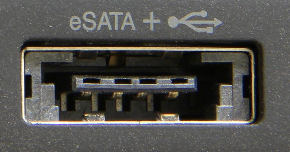

The blue one is normal USB type A port, while the one below micorUSB charging point is combo USB/eSATA port. I have one on my laptop.
[doublepost=1551320658,1551320395][/doublepost]Though I am little confused about this first port, which looks like two fused ports.
That first port is micro USB 3.0 port; it's an OTG port but otherwise a quite standard USB part.
I've long heard that the blue one is the one that carries USB2.0 and eSATA. I'm pretty sure the Pyra doesn't have a full sized 3.0 port, so if that blue one was just plain USB I'd have to assume it was a 3.0 type A, which I'm largely confident the Pyra doesn't have.
I'm not sure what's going on with that combined port on your laptop. Doesn't the cutout inside stop you inserting a USB 2.0 cage? Or does a 2.0 plug not align with the outside of the socket, and sit in the middle instead?
USB drive fits just fine in that port, it goes in the lower part. This port is actually larger in comparison with normal USB type A, so it can easily accommodate USB drive. I have never used eSATA though.
Blue is standard color for type 3.0 USB ports.
Ah, that explains the type-A lugs on the bottom only, I guess. So it's not like either of the Pyra's type-A capable ports then, which are both type A sized only.
Agreed. Pyra port looks different from USB/eSATA ports.
Yeah, which is why I remember; the blue port that looks like a usb 3.0 type A port is not actually a usb 3.0 type -A port in this revision of the CPU board at least (and probably any future ones where eSATA is still supported). The only USB 3.0 port is the micro USB one.
