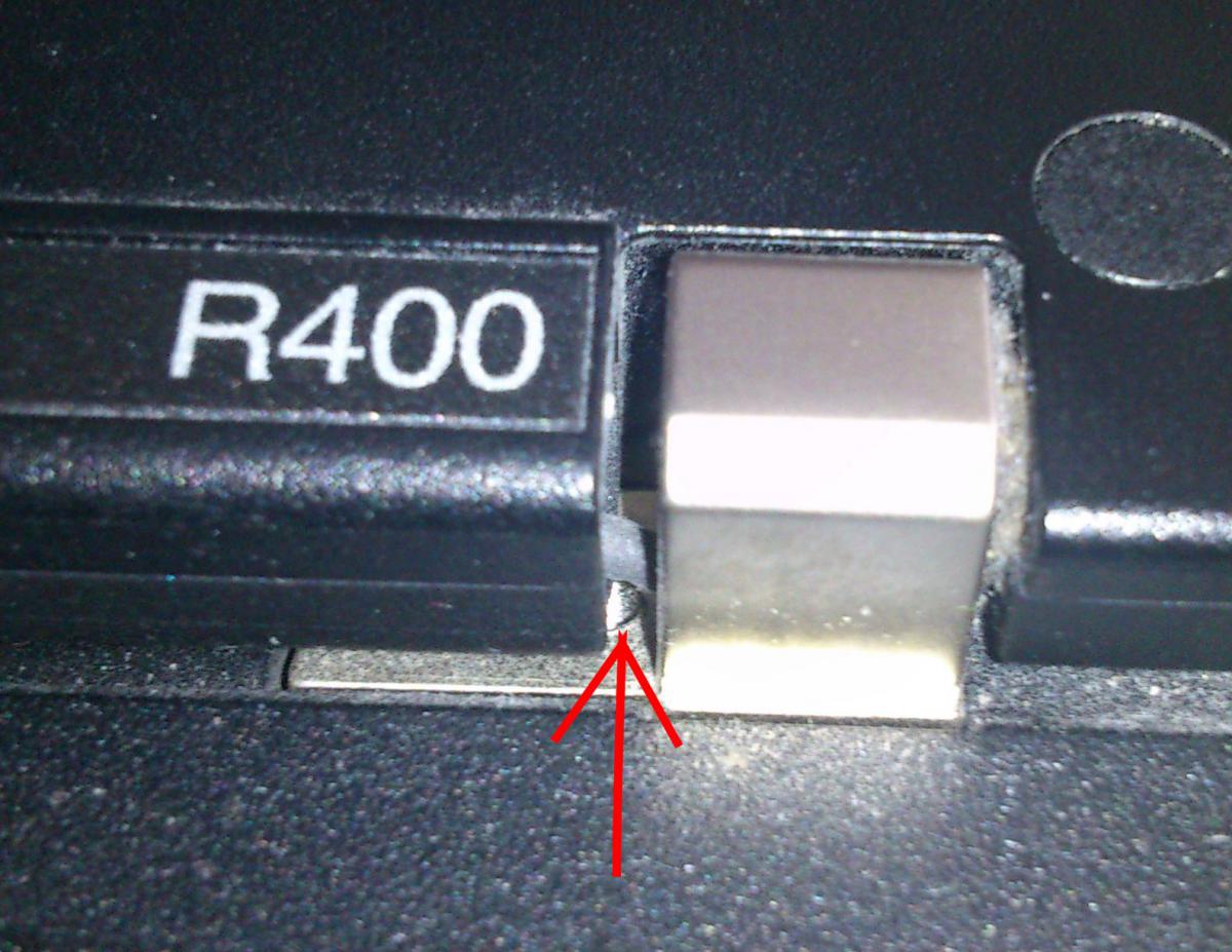

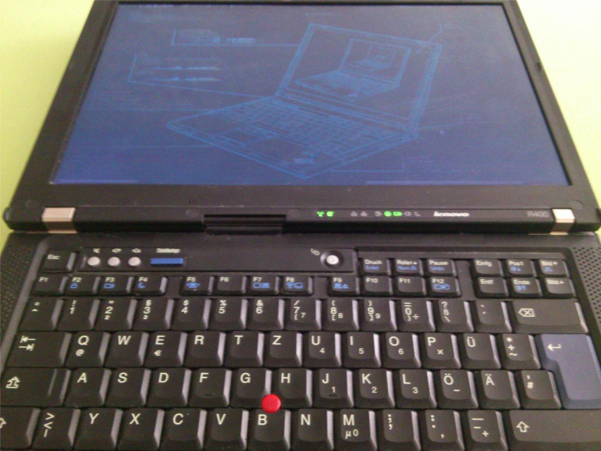

I want to compare the Pandora's hinge to an old Thinkpad (Don't complain about the dust: once they are a bit dusty, you will never get them completely clean anymore).
The Pandora has this clean flip phone style with the LCD cable inside the hinge.

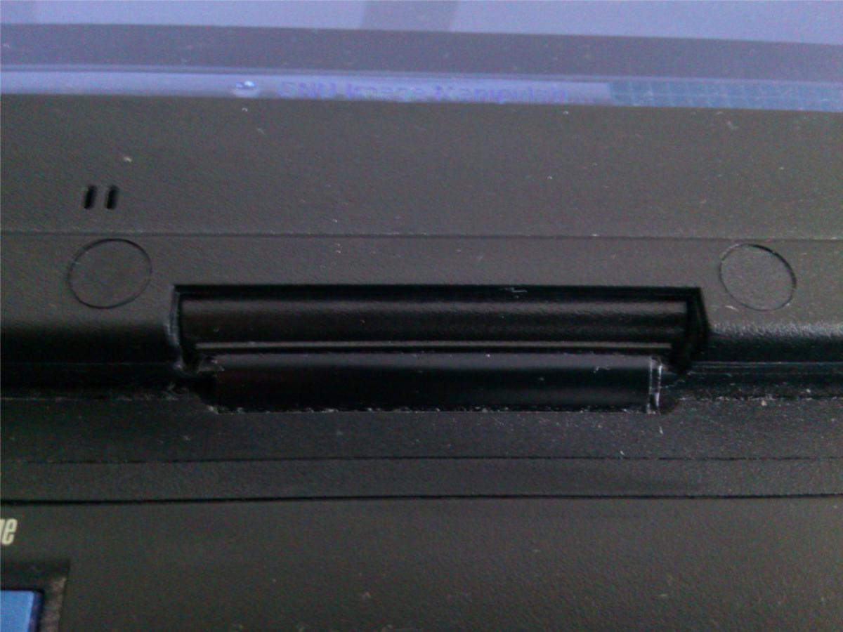

The Thinkpad has a notch for the LCD ribbon in the middle of the lid. That may not look that clean, but it's very robust.
The hinges are probably the most expensive part: they are small, made of stainless steel, have an opening angle of up to 180° and there are even the Wifi/Bluetooth cables in them.

Passing the LCD cable through in the middle of the lid could solve some problems and has following advantages:
- less stress for the cable
- possibility to use simple, but tough hinges
- less problems with electromagnetic interferences → more possible wiring inside the lid
- modder friendly
AFAIK there is no patent for this design, but I'm not sure.

is it still possible to open the lid without to touch the rest of the device with that solution?
Remember there 's more than the case.
The connecter for the cable has to be placed at the right position on the board as well.
As long as it works I also like the idea.
Yes, it is possible. It is just a hole in the lid. A notch on the downside of the bezel and the shell as well.
I mean if it's still possible.
For now I think the connector is placed where it is on the Pandora (Pretty much on the right side)
Doesn't it have ti be centered to work like this?
If so it might not work as parts on the board might have to be moved.
Changing the mainboard layout would be the technical cleanest way.
However, there should still be some space to pass the cable to the middle INSIDE the base unit.
The only thing which must happen is to redesign the LCD cable, but I guess they have to do this anyway.
