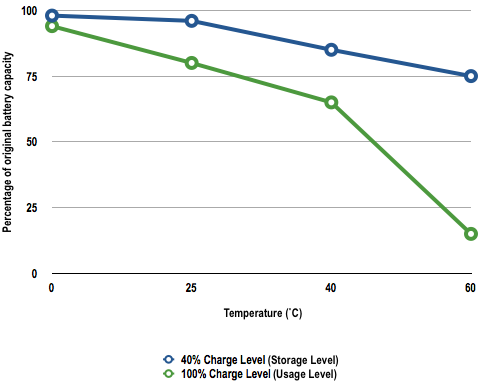

There's a very good piece at The Register
It has graphs 'n stuff ;)

And then there's the 100% charge will reduce life quicker than 40% charge. Keeping it plugged in will keep it topped up near 100%.
