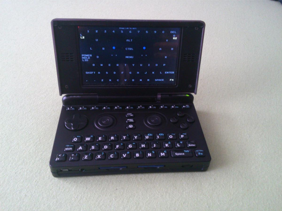

Last weekend, I met Askarus and we talked about his well known shoulder button mod. That encouraged me to add some shoulder buttons to my own Pandora, finally!
However, I was a bit afraid messing something up if I do the mod the traditional way, so I decided to make it a bit easier for me.

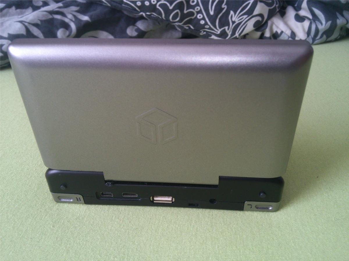

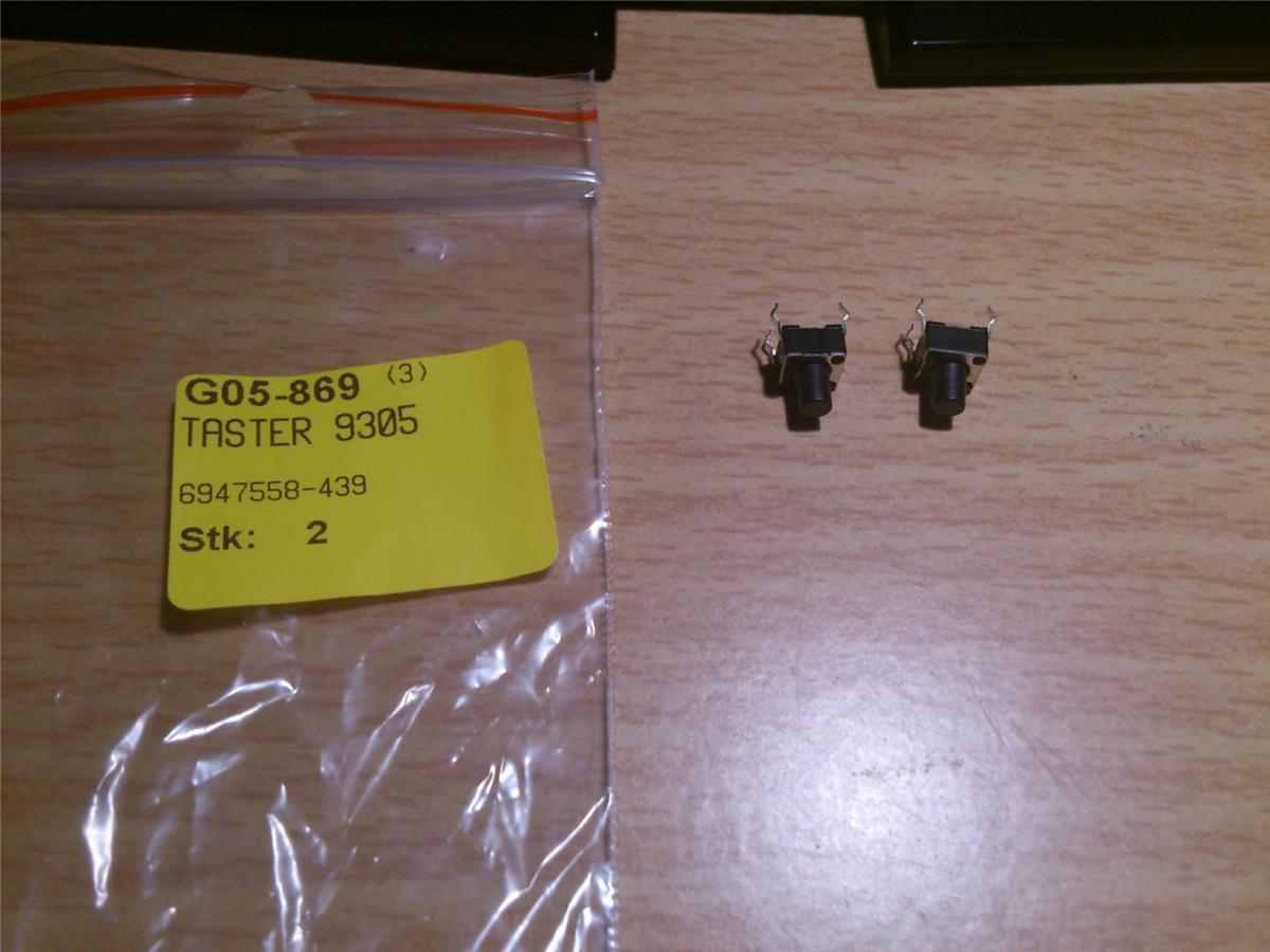

The plan was to go without real buttons. A little hole and a pushbutton should do, too.
A good position for the hole is 5mm from the edge where the original button sits and 11.5mm from the sides.

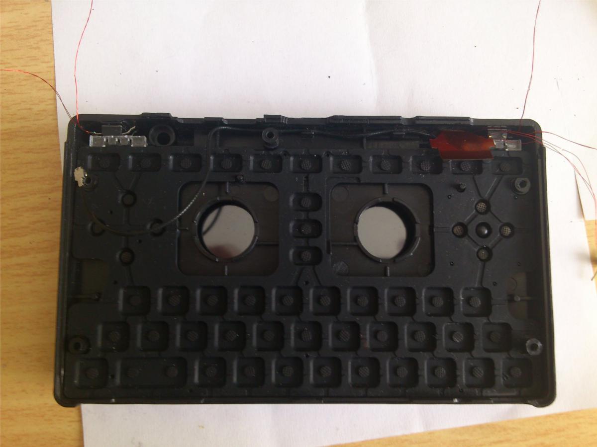

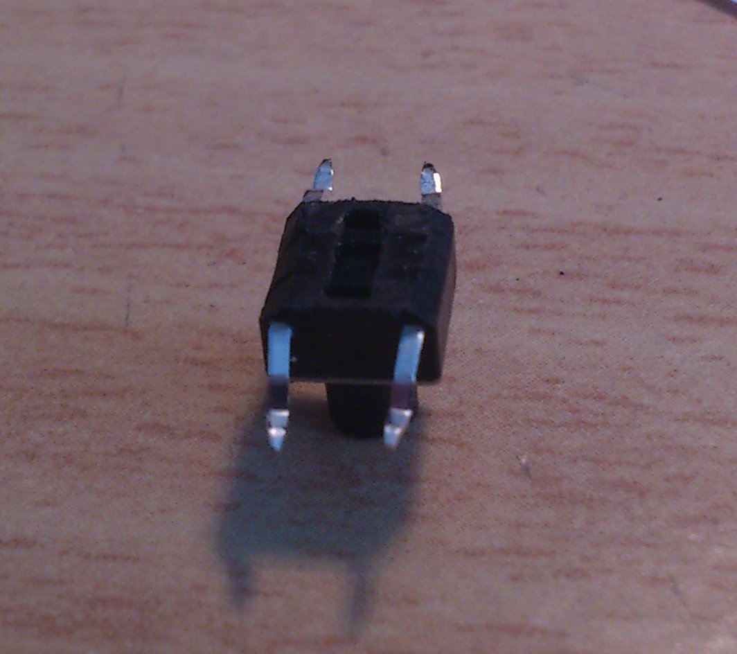

I had those two switches lying around.Their shaft has a length of 4.3mm . It turned out that that is too long to insert the switch in the Pandora case, so I had to shorten it a little bit. Also, I had to cut a bit of the switch's body in order to make it thin enough to fit it behind the light pipes.
Then I had to bevel edges of the switch, the light pipes and the case, so the switch can slide in. If you have inserted everything, you have to turn the switch around 90° or it will not sit straight. That means it would be pressed all the time.

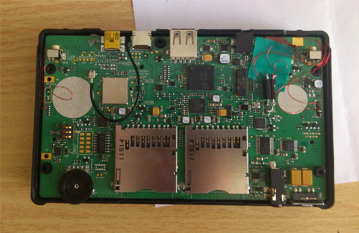

Solder all together as it should be (Don't wonder about my already done keyboard light mod).
And that's it!

Maybe one thing you should keep in mind:
Those buttons are not as comfortable as L1 and R1. You have to change your grip a little bit or press it with the last joint of your index finger.
... But at least, they are robust and reliable.
