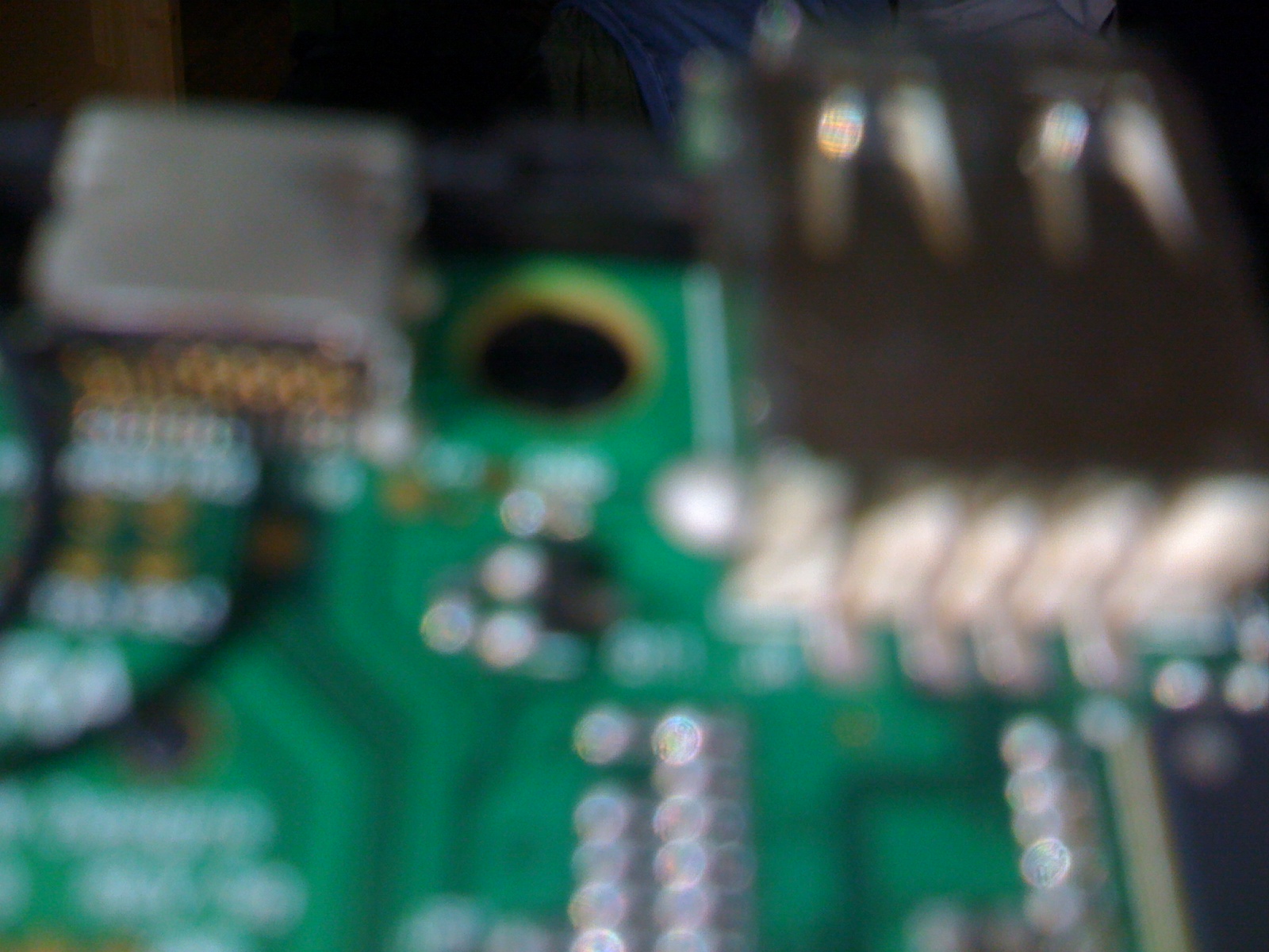

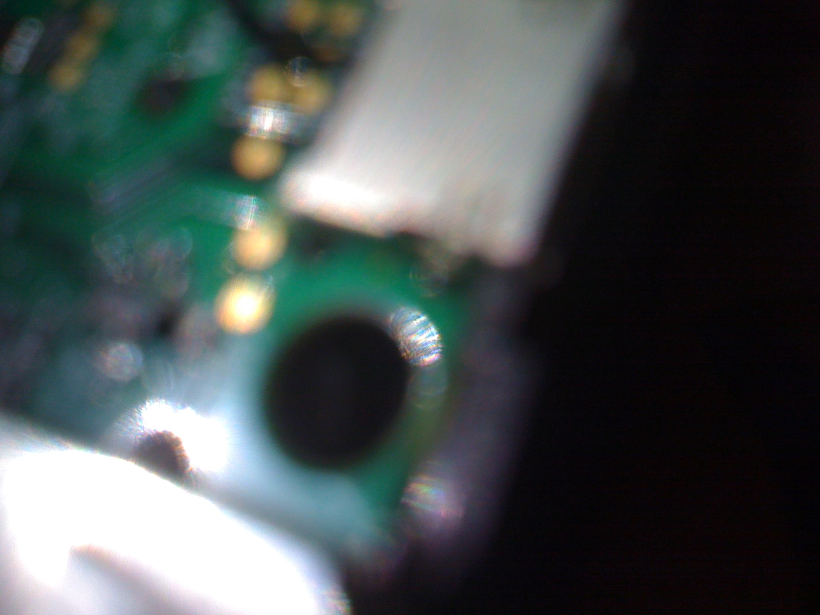

Before you return this as an RMA, can you take a picture? It's just that I'm not sure exactly what you are describing.
5 screws to open the unit, there are four under the battery. The 5th is at 12 O Clock if you are reading the sticker under the battery. This screw has nowhere to seat on the board. The board has plastic donuts the screws fit in. For the 5th screw, it has no donut on the board. The screw under the L button spins and will not seat either leaving the whole left side loose.
I don't want to take the units apart for comparitive pics. To the people building units, I hope my description makes sense.
There is a 5th screw non obscurred between the shoulder buttons.
The unit is being held together by 2 screws, not 5. I've investigated this further today in the sunlight and the plastic screw dock was initially there, but it has broken and what little remains is under the board. If there was a screw to put in this remaining bit of plastic, it would not hold anything.
I've tried screws from my other unit to see if it was just a bad screw perhaps because these things are not "machined" at all. It looks like someone is breaking them with a pliers or something to make them to size.
The 12 O'Clock Screw, the 1:30 Screw, and the 4:30 Screw are not doing anything to put any pressure on the case to hold it together and my left button is still fucked. I've tried messing with the foam, I think the fact there is no pressure to hold the case together means this button will not operate properly.

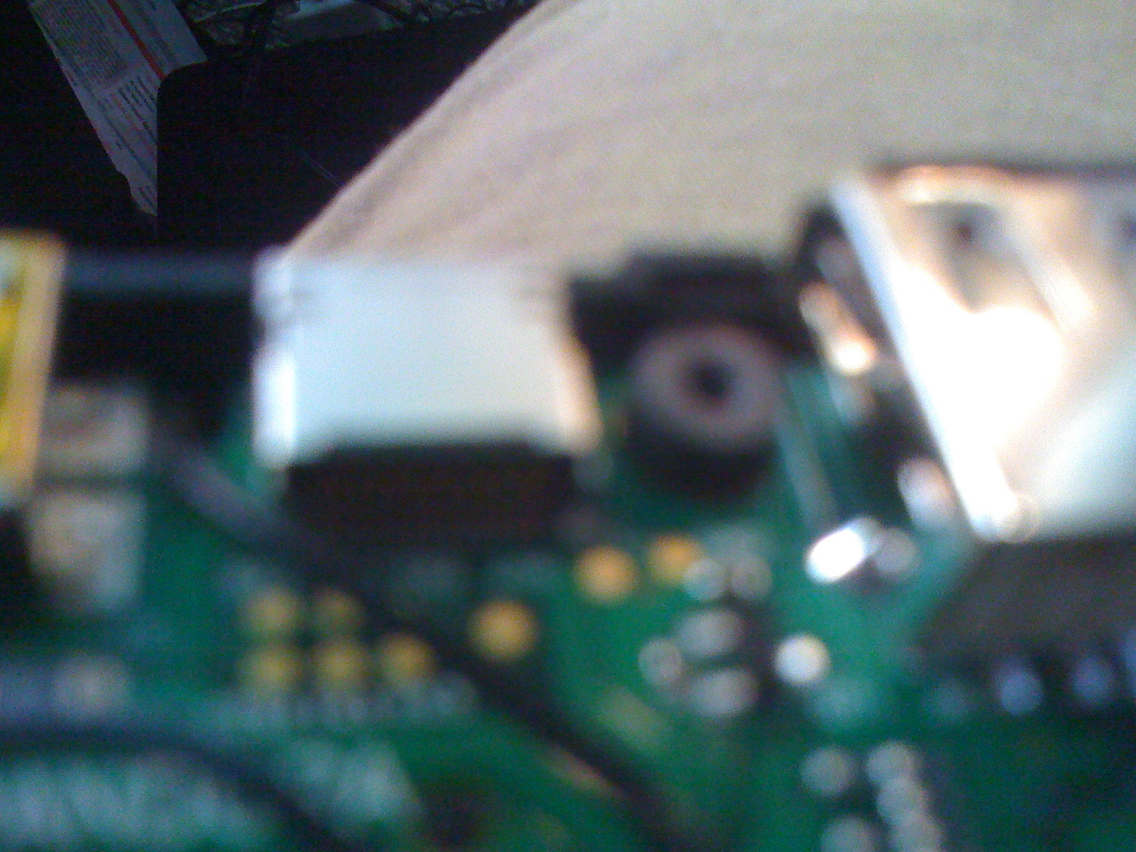

This is what #14 looks like. Also all of the screws work properly, everything is great on this unit.
...these things are not "machined" at all. It looks like someone is breaking them with a pliers or something to make them to size.
My screws looked like pretty standard self-tapping variety, with a little notch at the tip. 3 long and 2 short.

My eyesss! :lol:
Doesn't your camera come with a macro mode?
