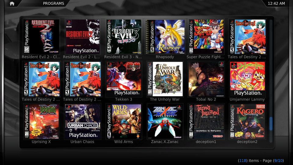

Also something like this is what I would imagine my pandora setup to look lik 8)
