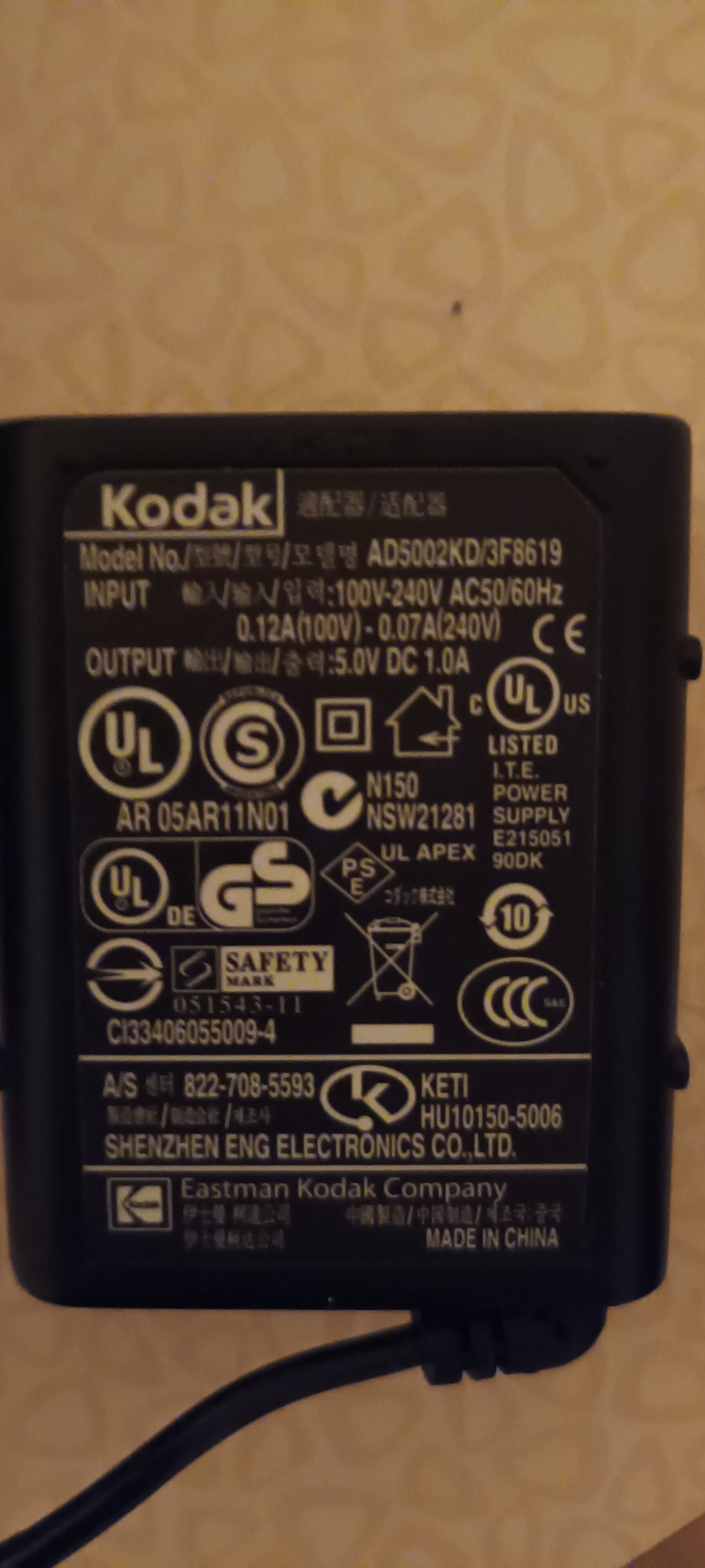

I also use my 2007 Kodak camera charger for the Pandora all the time
