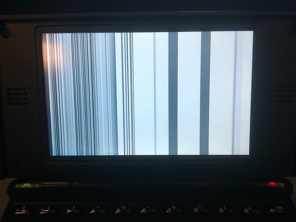

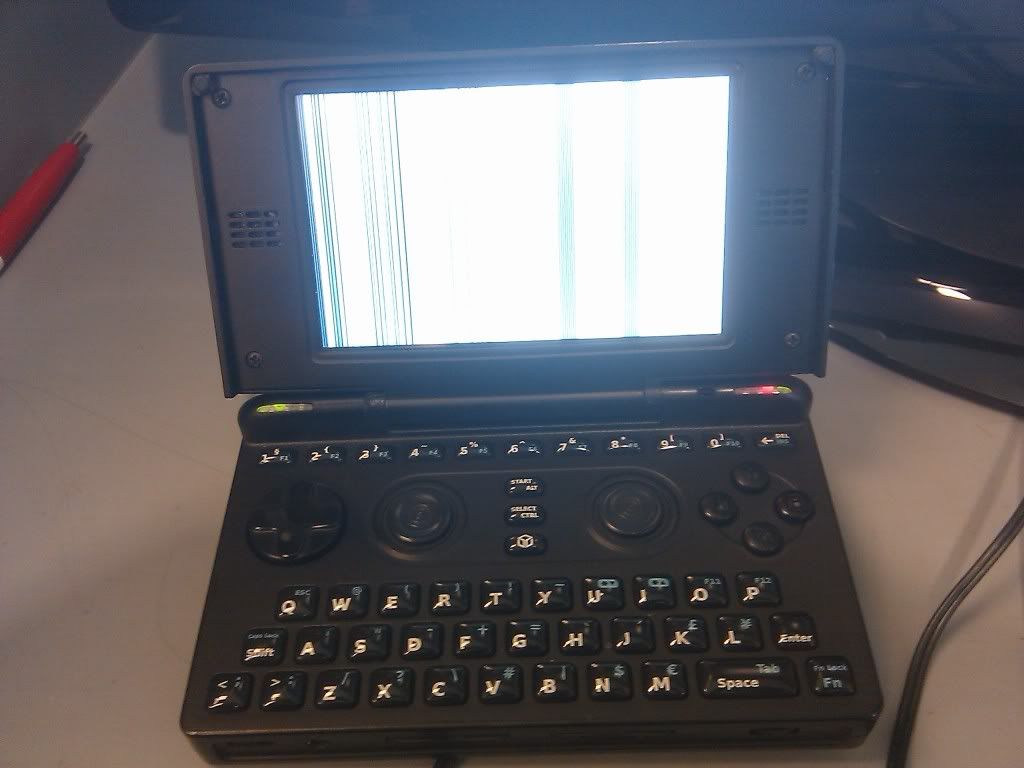

I have been experiencing similar behavior, and it is beginning to worry me. Random crashes completely freezing the system, and no help from pandabutton/power switch resets. I have to wait five minutes or so before I can get any sort of restart. Taking the battery out seems to help. I'll try a reflash and see if that helps, but this really seems to be a hardware issue since I seem to have to let it "cool off" before it will even allow me to reset.
Wow, after reset it just happened again as I type. I started up, pressed the start/alt button (as pressing the center button has been causing screen discoloration, I was checking to see if it got worse.) and the screen went purple then faded to white/black lines like in the photos below. After these crashes the lcd always looks like this:
After trying to reset/taking out battery. It will refuse to boot and the furthest left led will remain on. Eventually after several battery pulls it will work again.
And again! I just booted up, logged in and everything seemed fine. After pressing the D-pad once to navigate the bluetooth menu it reset! That's 3 resets in the last 20 minutes!
I'm sorry for seeming ridiculous, but I can't even get it to stay on long enough to find out what is happening! Now I'm just worried I won't be able to fix it. I'll try booting from the SD to see how that fares.

May I venture a guess that in this case, it is not resetting, but, as Alerino suggests, the LCD cable has failed?
It's what happened with mine, as well (except I had no tint as a warning).
A pretty surefire way to see if it's actually crashing or if it's that, is to have some music or a game playing - if the sound remains, you know for certain it's the LCD cable.
Really? I thought from the numerous battery pulls that this was a different issue. Hopefully this is something that can be fixed with an RMA.
