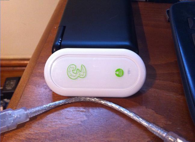

Prometheus!! I have a 3 mifi usb modem as well but when i plug it in, nothing happens!? So i can't actually get it to work. Could you give me some guidence on how to get it up and running! Thanks in advance.

You need to access it via the Pandora's WiFi - you shouldn't need to plug it in. The default out-of-the-box SSID and WPA2 Personal key should be on a little card that came in the box, and also printed inside the battery cover.

Hmm. it connects up to my pc fine. but it had to plug it in. maybe its different to yours i guess.
If it's a "MiFi" unit, it's supposed to be used wirelessly, as that's the whole point of it (unless you're in an area with an exceptionally poor signal, in which case they provide a short USB cable that I gather is meant to act as an extended antenna of sorts). :blink: I don't suppose you could provide a picture, please?

Yeaa, sure.
That's a Huawei E220 - it's not a "MiFi" device, it's a USB dongle. ;) You'll need to connect it to your Pandora with a USB 2.0 High Speed hub, because it's a USB 1.1 device.
It's outside of my knowledge (I went with a "MiFi" specifically to avoid dealing with setting up a USB device like this), but this thread from here and this thread from the other forum may be worth checking and/or posting to.
