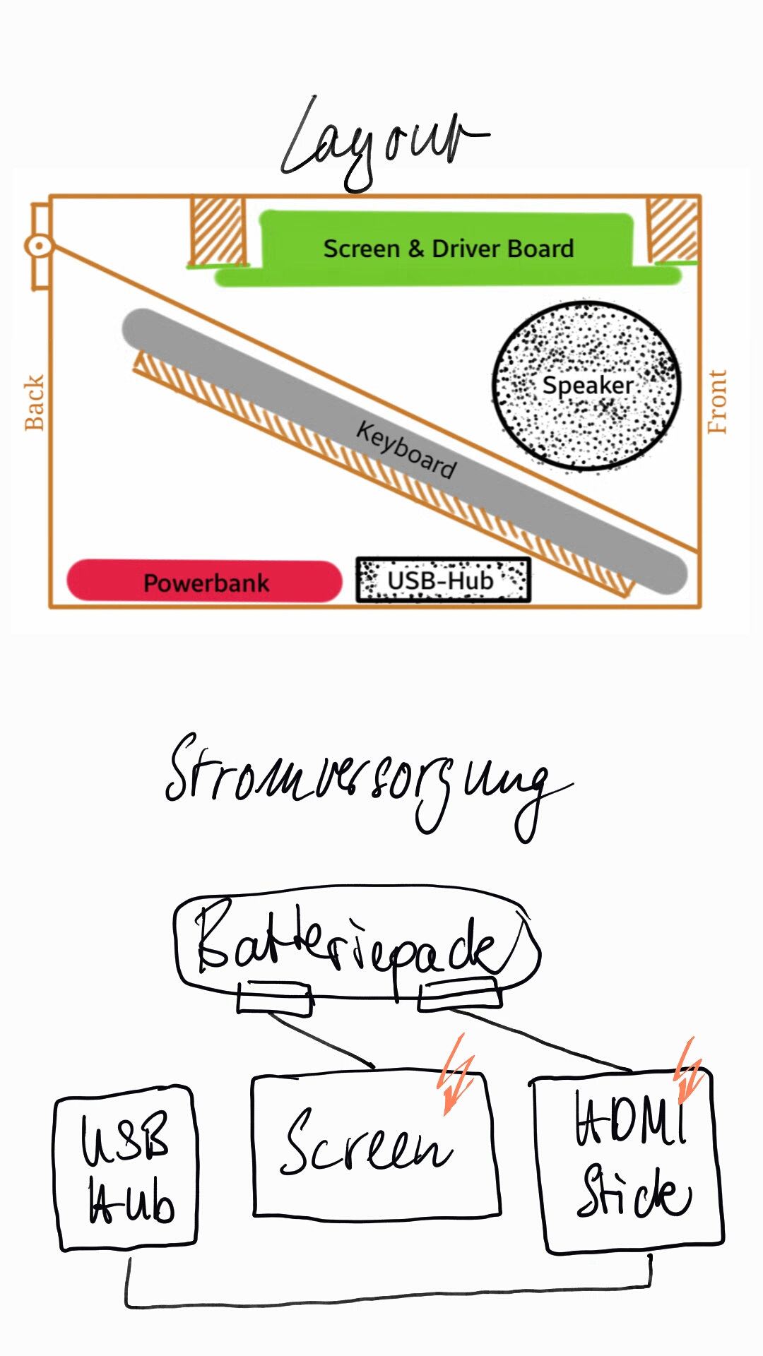

Maybe I'm just terrible at planning this. There must be a smarter way to do things.
I wanted to run the HDMI stick and the screen off a two-port portable powerbank AND connect a USB hub to the stick for peripherals. The stick's USB jack though delivers so little current that I need a powered hub, there's no way around.
I could get two of those powerbanks, that won't break the bank (heh). Still buy four Li-Ion 18650s, but two battery holders and split them up. Then I'd have four ports available internally. The power banks would have less load, produce less heat etc. Then I can just use any old powered USB 2.0 hub and be done.
Edit: Attachment below is old plan. Goshdarnit I love doodling things on the Note : D
