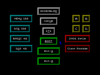

Keys in service rom (after reset)
U - Menu 128
S - Trdos 128
I - Basic 48
ENTER - Max Petrov's commander
