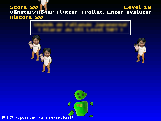

Thanks for this Puck, it's _definently_ much faster than "normal" fenix for GP2X. My game also doesn't crash anymore when I die, so it's much better. :)
However, for some reason my games are now cut off at the bottom and right of the screen for some reason. :eek:
CODE
set_mode(320,240,16);
should be working fine, should it not? Can't figure this out.

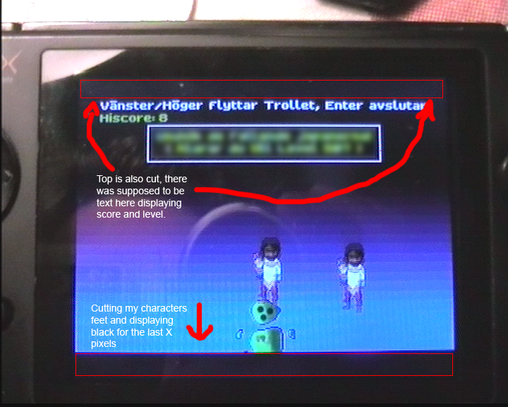

Unfortunately, even on the LCD-screen. :(
Burbruee said:
Unfortunenly, even on the LCD-screen. :(
But do you mean the picture is moved out the screen (so you lose area from up-left and see black in down-right) or just the picture is cut on down-right?
Puck2099 said:
Picture is cut and I see black in right and bottom of the screen. (Wrong, see edit.)
Just tried another of my games, it displays perfectly fine, which must mean there's something sneaky going on in my code of the other game.
However, on the other game I tried it runs much slower than with old fenix. Yet the first game runs faster but don't display properly.
I think I might need to look over how I write my code, and rewrite both games. :lol:
EDIT: Bottom is cut and I see black for perhaps the last 20 pixels, horizontally there is nothing black, but instead it's moved outside of the gp2x screen.
Sorry, I guess I was wrong. Right is NOT cut, OR moved outside of screen.
But bottom and TOP is cut. I didn't notice at first, since the top of the screen is supposed to be black.
I just noticed how "Score" was missing.
I made some screens:
This is how it's supposed to look, screen taken by get_screen() function in fenix.
This is how it looks on my GP2X, screen taken by Panasonic NV-GS80.
This worked perfect on the old Fenix2x, but still I find it strange that this error doesn't occur with all games.
I just downloaded Fenix 0.92a for my PC and tried to run it, works fine. So must be ufenix related?
I had the same problem with my ROTT port, I think it's a problem related to SDL.
In some hours or tomorrow I'll recompile it with another SDL version and give you a link to try it :)
