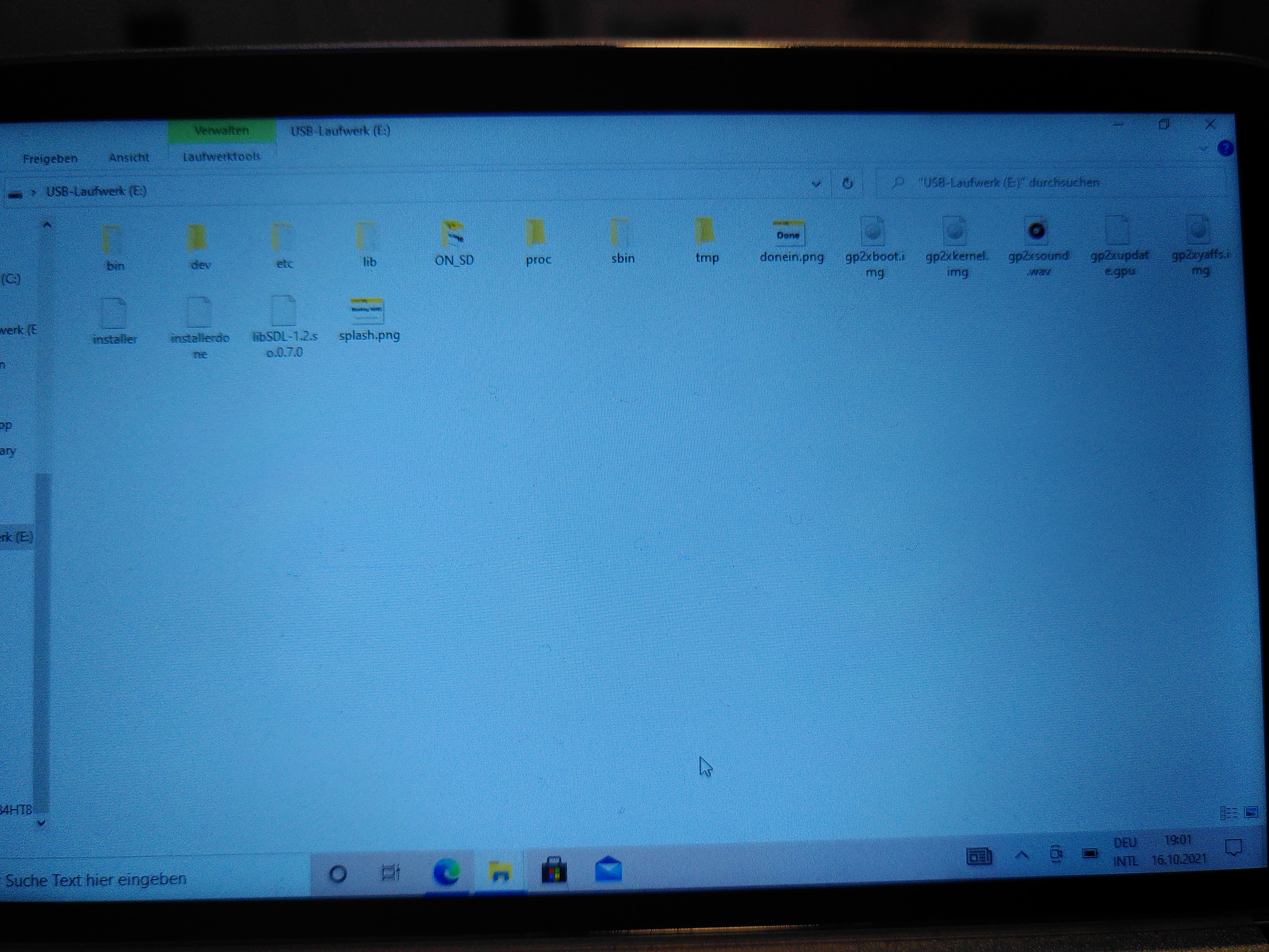

so i copied the content:
Post automatically merged:
Here is the folder

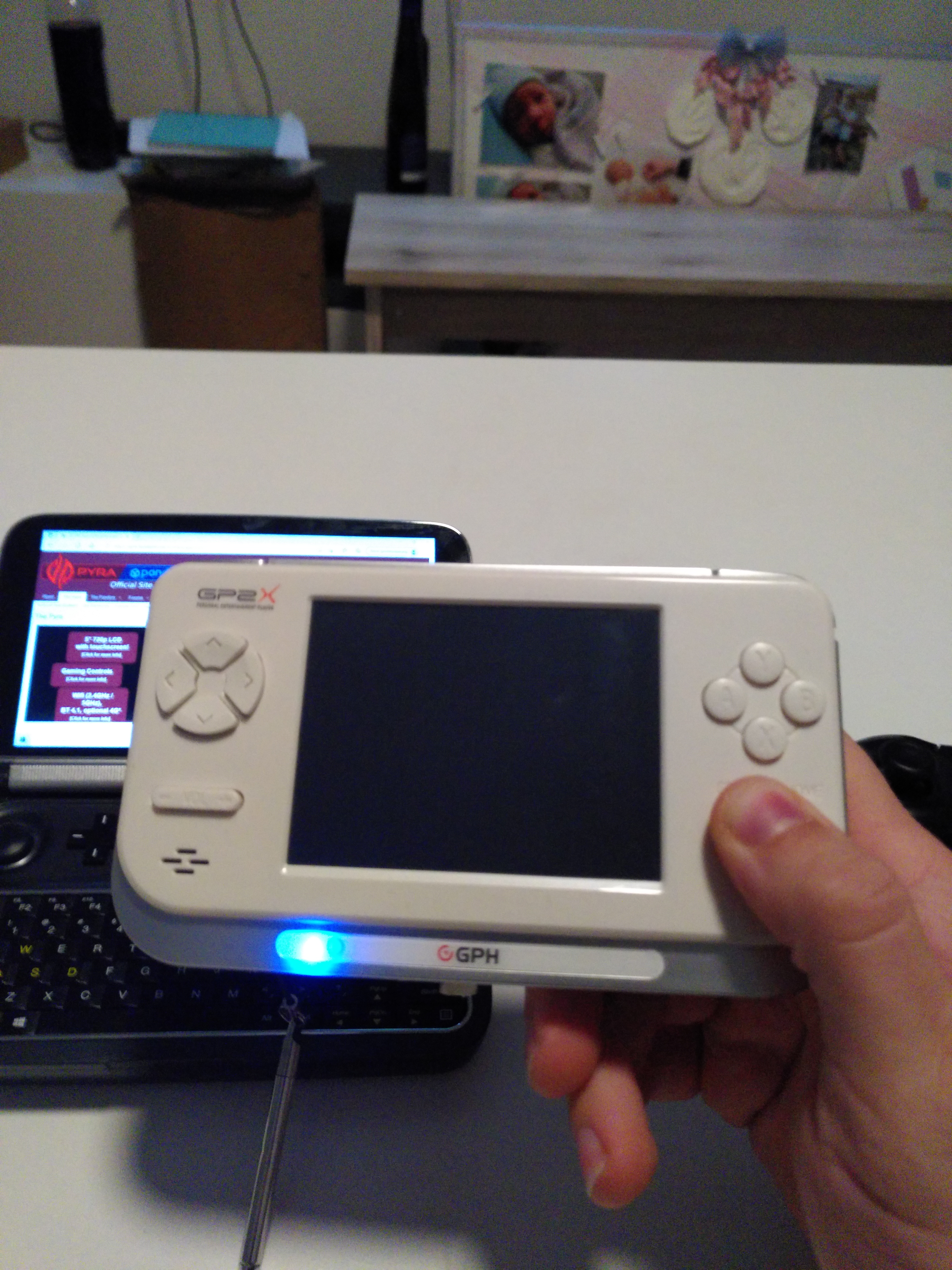

So i press select and start and it does not work
Screen is still black. What do i wrong?

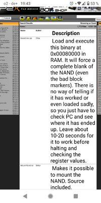

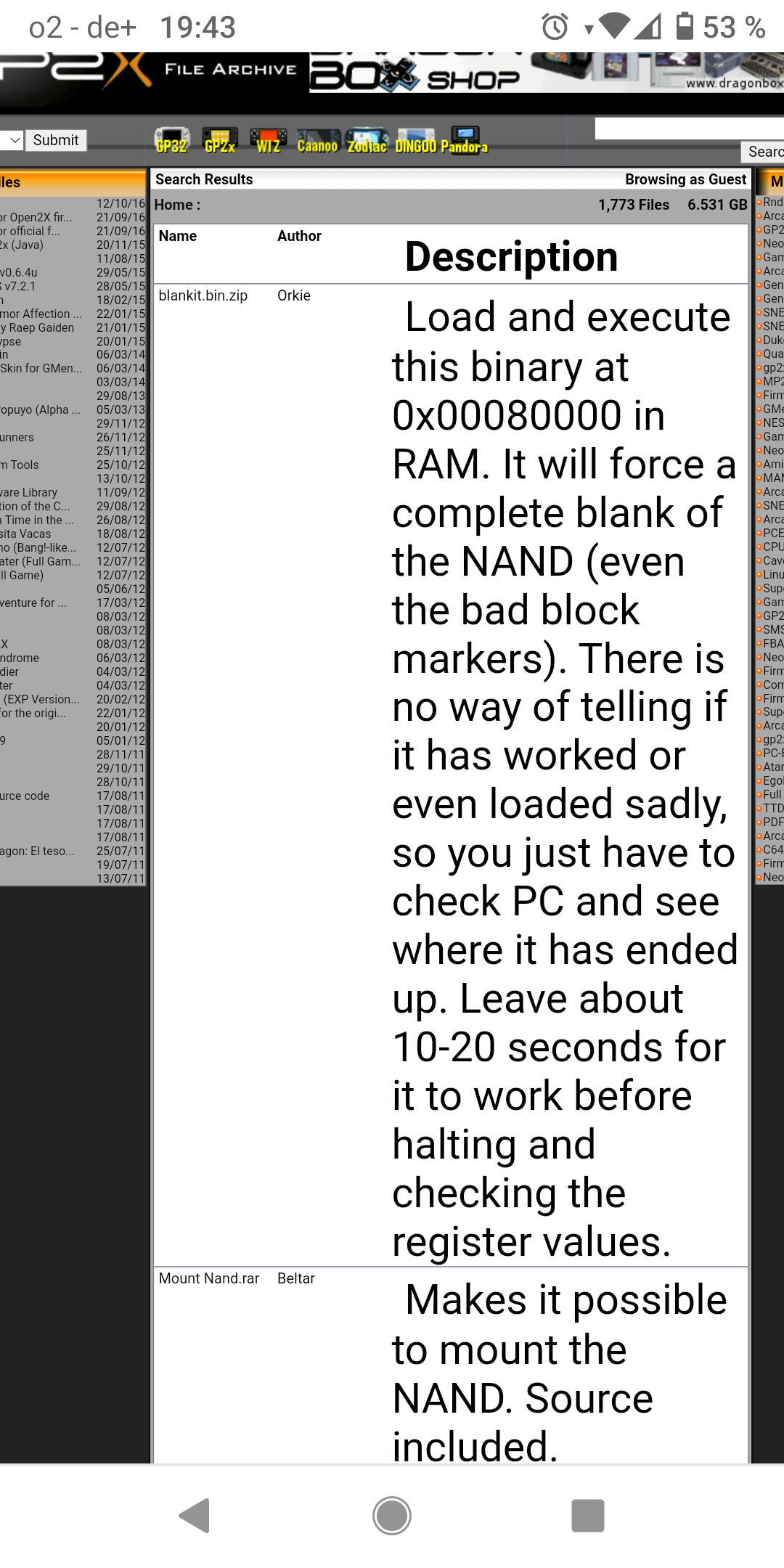

There is another nandblanker, but i can't figure out to use it. I mean, how do i write some stuff on a specific place in ram???

I doubt the nand blanker is going to help you, it is for repairing a very specific problem. You appear to have no bootloader at all if you get nothing on the screen.
Do you definitely have a working JTAG setup? If so, you could try following DJWillis' old unbricking guide which should still work: https://web.archive.org/web/2016031...2005/11/howto-unbrick-most-bricked-gp2xs.html
Remember that you'll need to flash an F200 bootloader, and the elf format bootloader floating around on the archives may not display anything on the screen as it was designed for the F100, but it should work, and will have serial output.
Alternatively, you could try running the open2x bootloader elf using openocd: https://github.com/devkitPro/orcus/wiki/Getting-Started#running-via-jtagdebugging / https://github.com/Orkie/open2x-bootloader/releases/tag/v1.0
You'd then need to have a patched GPH uboot on your SD card, which you could then launch from the open2x filer, and flash a new bootloader that way: https://github.com/Orkie/patched-gph-uboot/releases/
