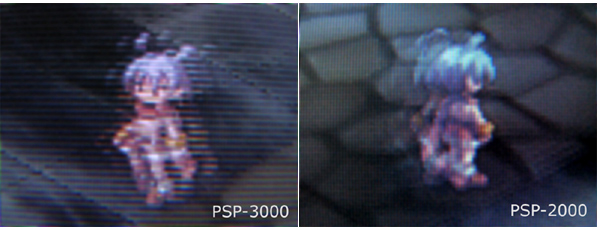

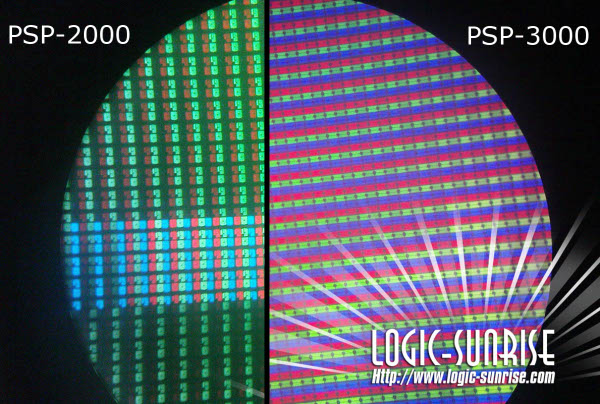

I see that a new LCD design in the new version of the Sony PSP has a basic LCD defect.
It seems that the old LCD's used a vertical color pixel row alignment, and gave good performance.
The new display, while brighter, uses a horizontal pixel alignment.
This causes video display, which is scanned top to bottom, to give what appears to be Interlace distortion.
My question:
Which style is the new Pandora LCD?
This could cause a world of suck, if the "new improved" design is used.
Anyone know the answer?

The real comedy about the PSP 3000, is that Sony has responded to this defect by calling it a "feature." Some feature.
I can confirm there are no such problems with Pandora's LCD. And I'm quite picky on such things, for some reason my GP2X F200 does have interlacing artifacts (it isn't supposed to), while F100 doesn't.
Also confirm that the alignment is vertical so it can get neat font-sub-pixeling (Like it's needed :D )
I heard rumors that the new Nintendo DSi which was recently released in Japan has the same problems as the new PSP. So fears that this will become common among new handhelds are not unfounded.

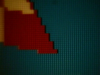

How can I determine alignment? This is the best I could get with my ancient webcam:
(BTW, guess where this fragment is from)

This is vertical alignment. (the blue forms vertical lines when you look closely at a solid blue area).

Thanks, Notaz.
What display is that photo from?
